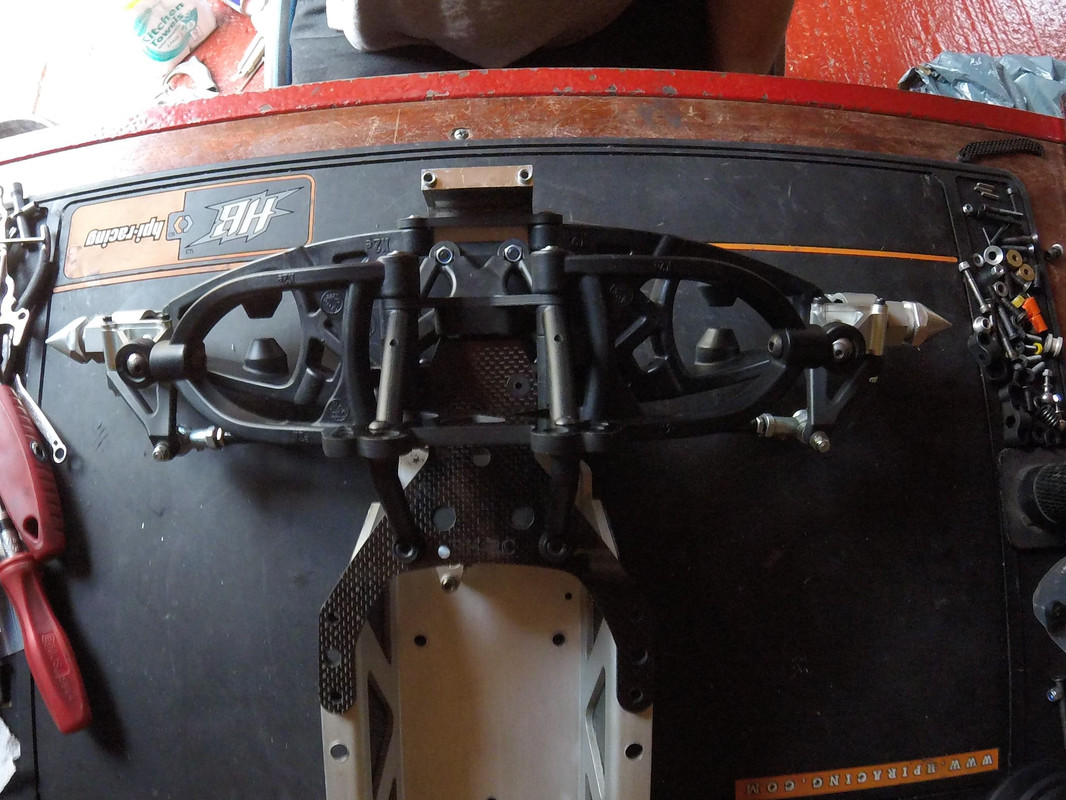

Looking for a kick in the rite direction. What are we using for spacers on the front upper? This is going into my Taylor 50 build.
And rears. I bought the Taylor spacer kit and Taylor aluminum heim joints.

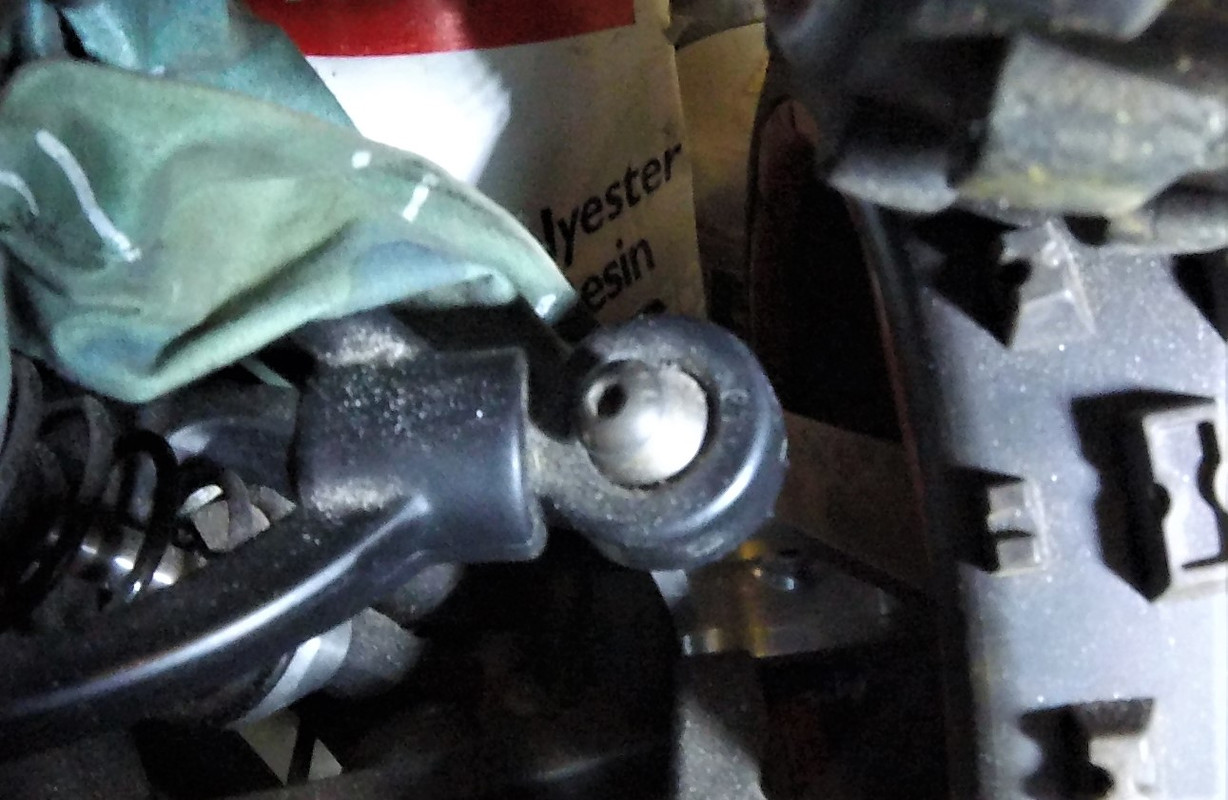

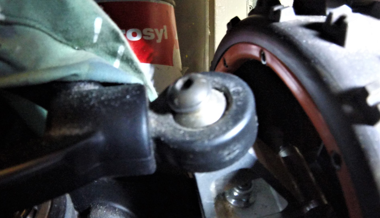

Could I bother you for a Pic of the top of the heim? See how much is sticking out. Front upper
i'll try and get you a pic or at least a measurement later today clubin,
my bajas are packed away at moment cos have 1;1 car in workshop to do some work on it,
think i can get a pic though (y)
@Clubin , couple pics, not the best but its all i can get at the moment,
poor old baja is stacked and cant remove from where its stored :LOL:,
anyways, the measurement i took is 6mm or 1/4 inch from the outer edge of the a arm to the ridge of the ball that the screw sits against on stock plastic heim,
that gives on mine about 1 degree of camber on the front, hope this helps (y),

Thanks for the pictures. I figured I’d ask because the front is kind of a bugger to adjust. At least this will get me close.
I can confirm that there are no spacers required.
i suppose it just depends how long the heims are that ya use clubin,
pretty sure i have a 2 or 3mm spacer in mine, but with plastic heims,
proper good you didnt need any though (y)(y)
