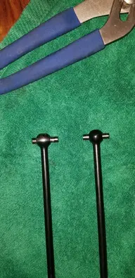

Ok. ...pin aint gonna stay in....
You can see the difference in the 2.
And in the process of replacing.....i ripped the boot.:banghead:.
