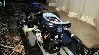

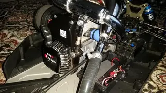

here's my 5t with g320 and ddm dominator stock gearing and ddm black heavy duty spring all around and ofcourse killer bee kill switch. i also dremeled out the stock clutch housing like the aftermarket one for better cooling it didnt turn out too bad lol. everthing else is stock just need to play with the carb setting alittle i also had to reweld the ddm dominator supprotbracket beacuse i didnt like the way it fits20140705_191706.webp

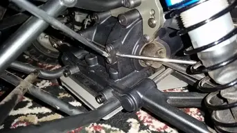

20140705_191934.webp. also i uploaded a pic of the sway bar i need to know if the little grub screw needs to be tight against the sway bar thanks.
If they are not tight snuged up to bar the same the handling will not be the same when you turn left or right just snug them up so no play in or out
here's my 5t with g320 and ddm dominator stock gearing and ddm black heavy duty spring all around and ofcourse killer bee kill switch. i also dremeled out the stock clutch housing like the aftermarket one for better cooling it didnt turn out too bad lol. everthing else is stock just need to play with the carb setting alittle i also had to reweld the ddm dominator supprotbracket beacuse i didnt like the way it fitsView attachment 9689
Looks great!! I would recommend dumping that pipe and getting one that is mounted on the chassis. It's a lot more stable and you'll find it won't come loose during a race or bashing. I'd recommend a Bartolone XP pipe. You won't regret it. Good Luck!
Thanks :) I just got the 5t about 2 month ago and my wallet is still recovering so I bought the ddm dominator @ 114 bucks from ddm. So for now is going to have to do lol. Just got a full force rc fuel line kit I'm about to install
Make sure the filter lays in the dip in the tank or your motor will run out of fuel at less than half a tank
