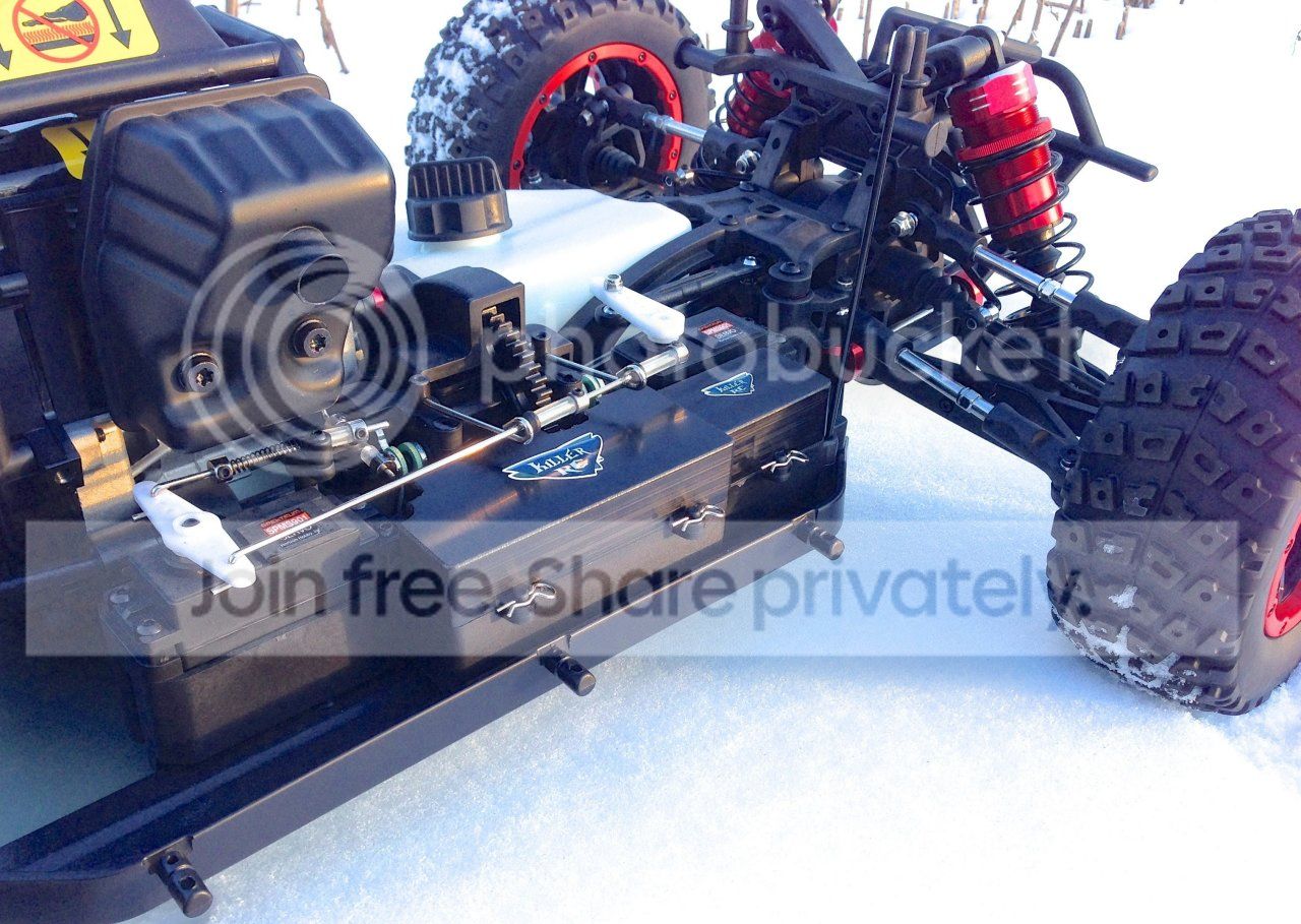

Since i have the DBXL that using the ni-mh batery was giving me "#$"#$"#.....
Killer RC 2s li-fe 6.6v 2600mah for 40€?
Killer RC taller cover for lipo & receiver for 35€?
How about 2s 1450mah from Turnigy for 16€ that will fit nice? (need to wire them parallel)
Giving a 2900mah 2s 6.6v that will move the servos like it should, and not kill them like a 2s lipo will do?
-GRRRR nimh, bye!!
-Two 2s 6.6v wired in parallel by me!.
-Also made a cover for ther balance plug. I have the Deans cover...not on pictures!
No need to remove & open the box with all the stress that involves. Just conect cable and charge on the GO!
Servos now do move...and are still safe. Need to test it, but now i see no point on changing them before they die.....later 7.4v will come...but for now....
SHAME that they use a 1700mah 6v ni-mh from stock!
AHhahahhahaha.....yahahahaha you can have a 7.4v 2s lipo in there but need to buy 2 more servos that handle 2s lipo ...that's going to be at least more 150€-200€ depending on servos and lipo... and also de KillerRC taller covers... For 17€, stock servos will move like a servo.
