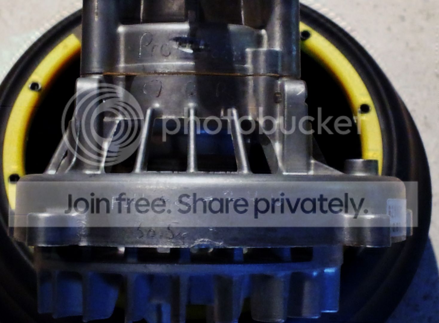

Prostroke is out of the buggy, ready to be dropped off tomorrow when I pick up the OBR built 5b, 30.5 3mm long stroke, custom paint buggy. Hint, the paint job is NAVY!
The Prostroke will be a Pro Build Losi, and I won't have anything indicating it's other then what I was running before. OBR builds Zenoah engines, the DR needs a HY fan case, so I stripped everything off the engine. So unless you look closely when I reinstall everything, ... Sleeper.
