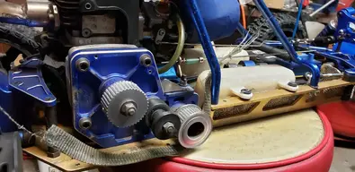

So then I finally get off my ass and take two 5th scales out for a bit yesterday. Took the Dunerunner out. It broke. Stopped dead in its tracks and revved up without movement. So I suspected a broken drive belt. But it wouldn't roll at all. All four wheels locked up. So I get it home to find the belt did indeed break. But it jammed up between the brake shaft pulley and the belt cover locking the wheels. Come to find a little pebble down in a grubscrew hole on the clutch bell pulley. Think clear silicone is going in there now. Check this out hahahaha.20191103_164702.webp20191103_164758.webp
I had a grub screw come out and get jammed between the belt on the bottom pulley and the cover.
Got hot enough to put a gouge in the belt and melt a hole in the cover but never stopped.
I think I'll get the silicone out after your experience.

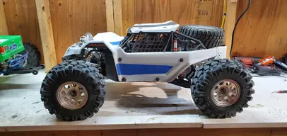

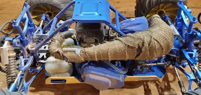

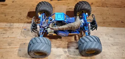

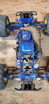

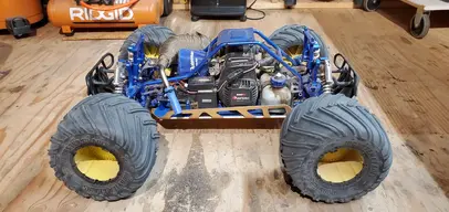

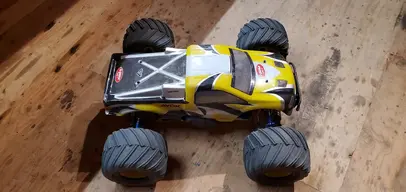

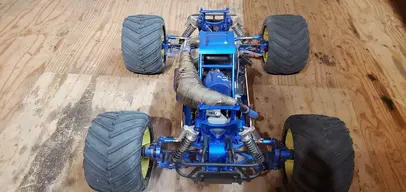

To everyones answer about belt drive. get it. You can't go wrong. To any new guys. Follow Steel City RC. I'm pretty anal about following his vids. (thats if you can't tell by looking at my truck). And yes he was off for a while...lol..whats up with that GS...lol. Every video he has has gotten me through all my questions. As for my truck, yes, its a Maverick Black Out. For many of you its HPI duplicate of the Redcat Rampage MT. Stick with the Redcat. For we have named this truck "Cursed". It just is. Any questions i will do my best. But G-Man is the man.
PS...G-Man aka GS. How many items do you recognize...:))

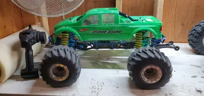

PSS. My other two babies. The LST is my pride. But the Losi SRR is getting there. LST is now an electric. No more Nitro :(
