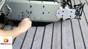

I just went to install my new engine and it doesn't seem to want to fit. It is just a little more narrow than it should be. Am I overlooking something? I'm still new but this just seems odd. Pic included.
Are you saying front to back or left to right? It looks about right to me. I wish I had time to stop by and help you, but I am stupid busy right now....It helped me to have the center diff. installed first so that the mesh was set at the same time. It could be the inserts are turned around....the other thing I have to do from time to time is leave all 4 loose and then star pattern tighten them to squeeze in to place.
Yeah its from front to back. Seems to be about 2 or so millimeter short.
