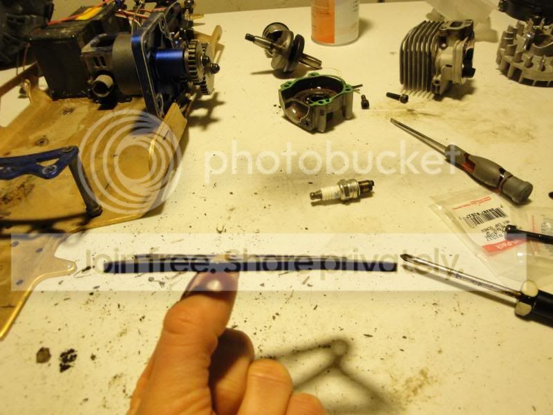

I went over and notice that the front center dogbone is bent. MAD. I also noticed that the throttle/brake was acting up, so I took a look at the linkages and operation of the servo and all was good...then I touched the outerwear and noticed that it was very floppy, and upon further inspection, the inside of the filter shattered due to the roll cage brace pushing into it. MAD MAD. Front end of the chassis is pretty tweaked too, along with the blue front upper chassis brace. MAD MAD MAD. After taking apart the filter, I only found 3 of the 5 plastic tower things...later I found one inside of the carb :eek: which left one unaccounted for which made me :eek: more because where else could it have gone besides...you guessed it, inside of the motor. Started ripping everything apart and noticed a chunk of a foreign object on top of the piston which actually looked like a chunk of metal :eek: until I got it out and noticed that it was a pancaked piece of plastic :D . The spark plug also had quite a bit of crap on it, which I am positive is some more melted plastic bits. I am doing a complete tear down of the motor to make sure that I get all of the plastic bits out.
Anyone think that there could have been some damage to the motor from the plastic tower, or is the evidence showing that the motor just blew it into microscopic pieces? What should I look for to make sure that everything is good working condition?

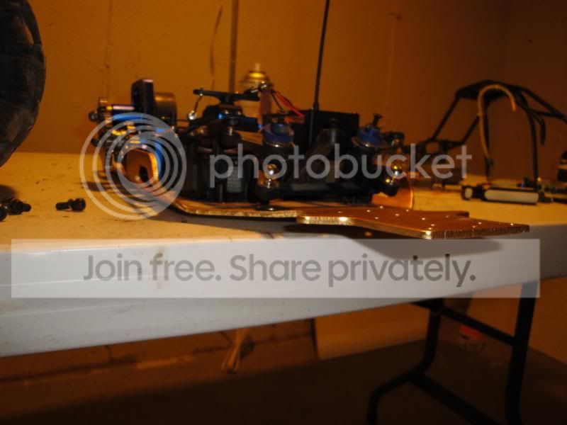

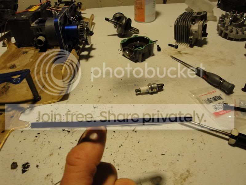

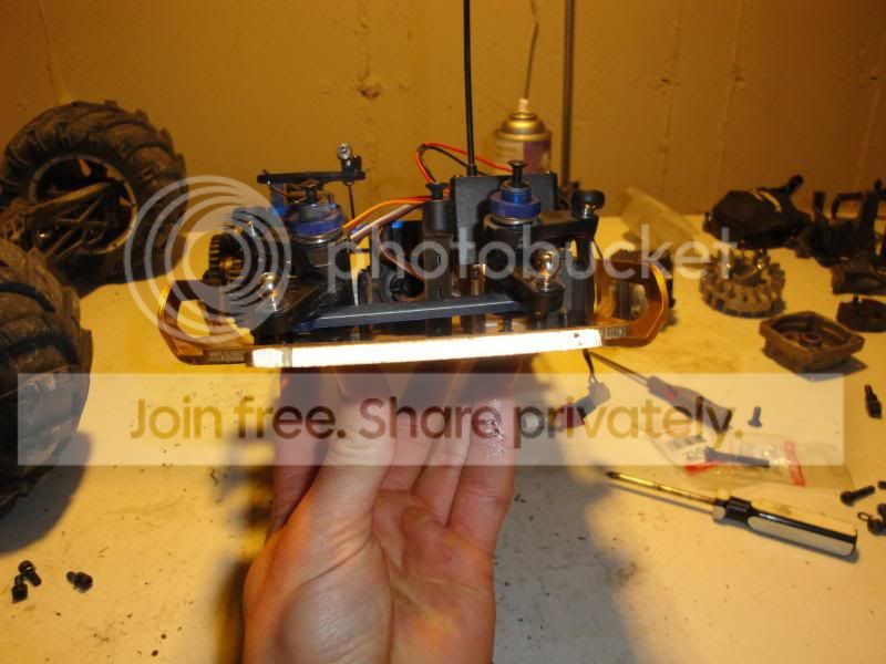

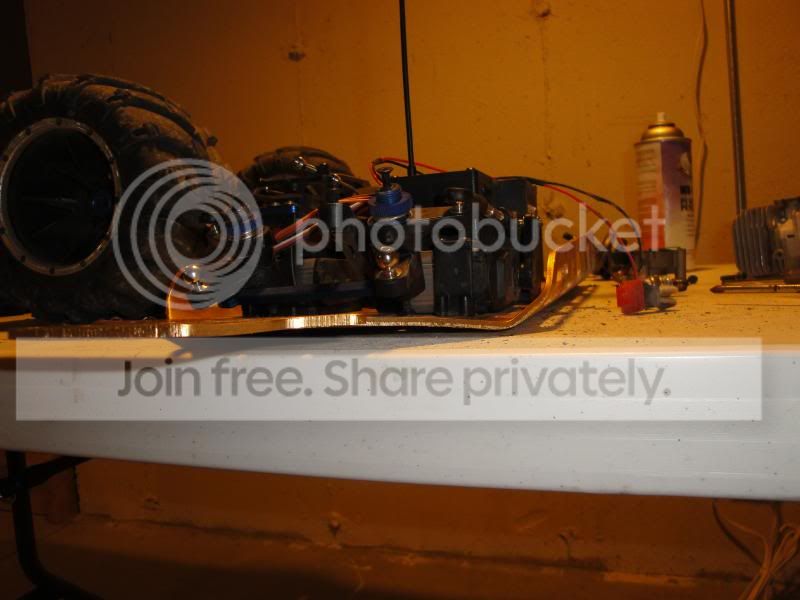

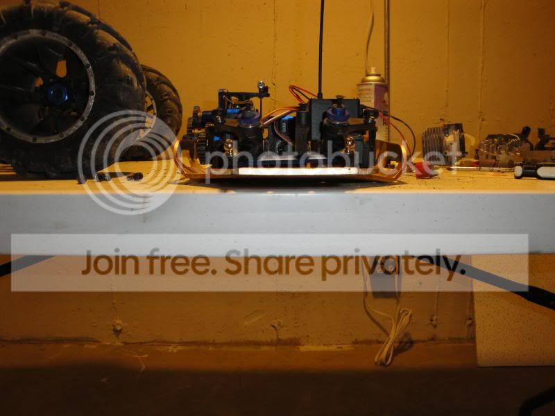

I was able to bend the chassis back a bit, but one of the ends is still slightly tweaked...should I still get a new one? And what about the blue brace, tweaked enough to need replacing?

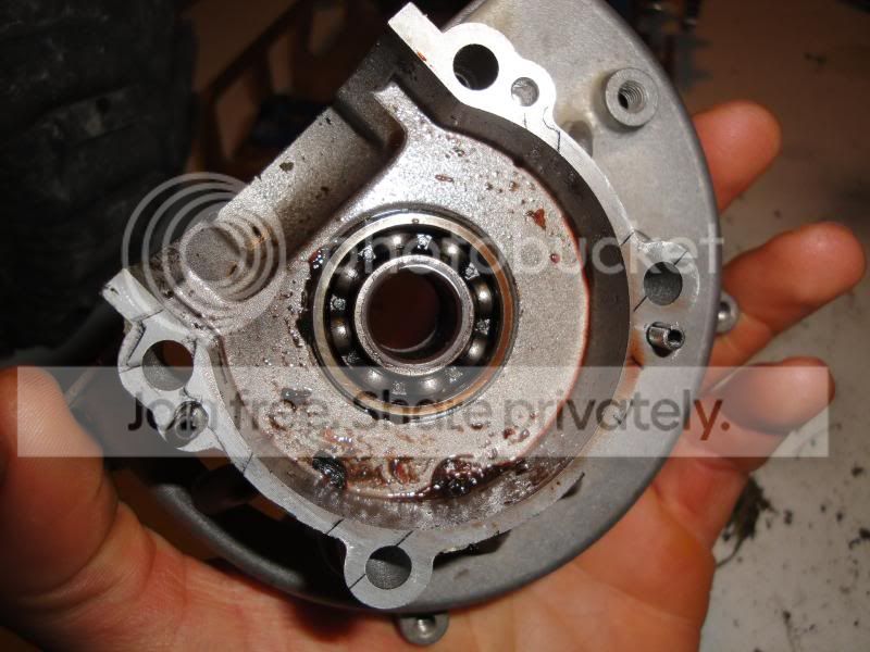

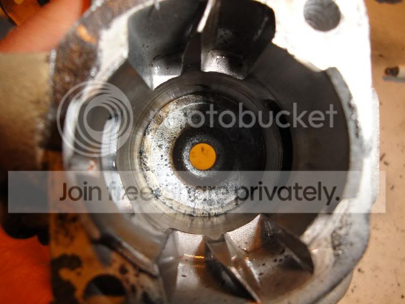

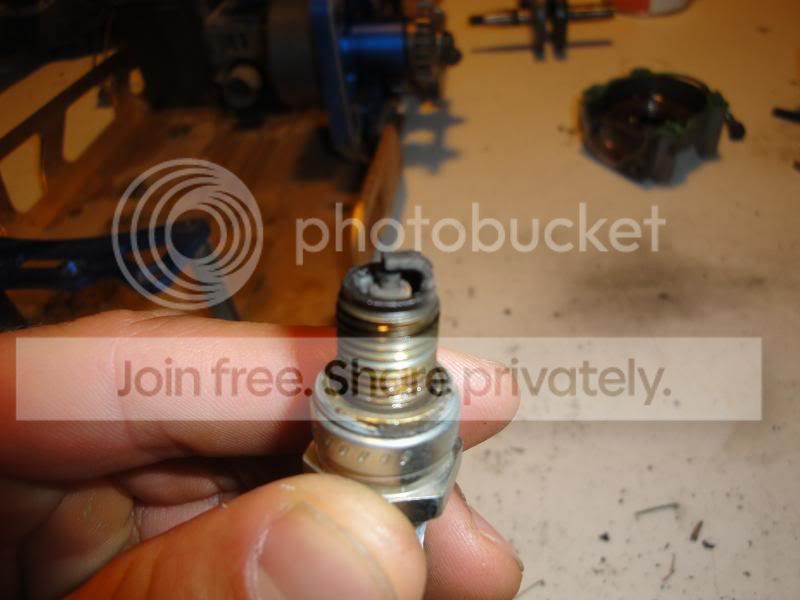

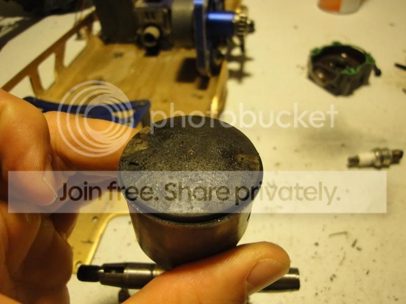

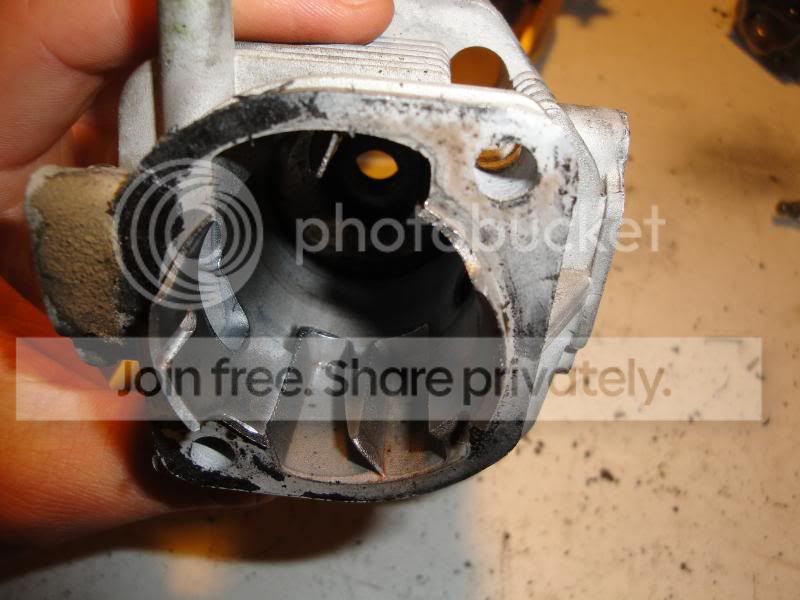

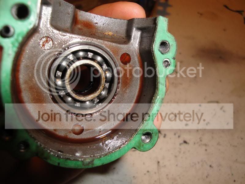

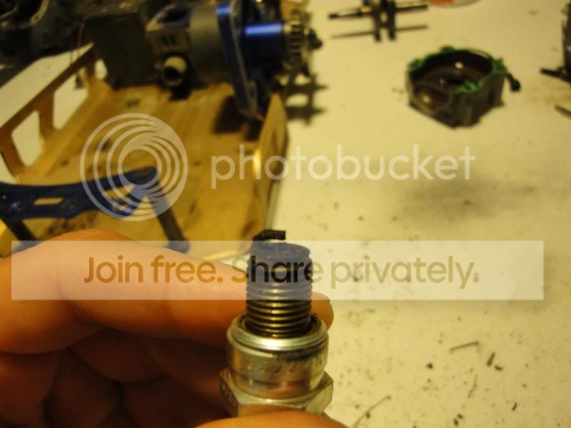

How does the piston, sleeve, and plug look? I have cleaned everything off now, but is the color from a "healthy" engine?
Just straighten the chassis and other pieces as best you can and keep using them unless it bugs you. Spark plug looks like it needs to be replaced but from the pictures the motor looks okay. Clean it and put it back together with new gaskets.
as long as drive line is tension free you can run the chassis, it will continue to deform but somewhere else. and tracking may have issues.
hard see the total extent , i can see the twist for sure, the front definitely got jacked!
those are stout chassis' i would run it.
and maybe change 2 stroke oil, ton of carbon, what are u running now?

Homelite premium synthetic blend from Home Depot, mixed at a little over 25:1
