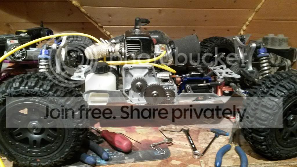

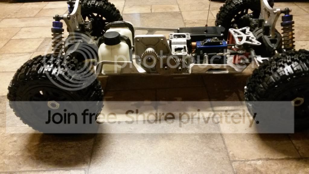

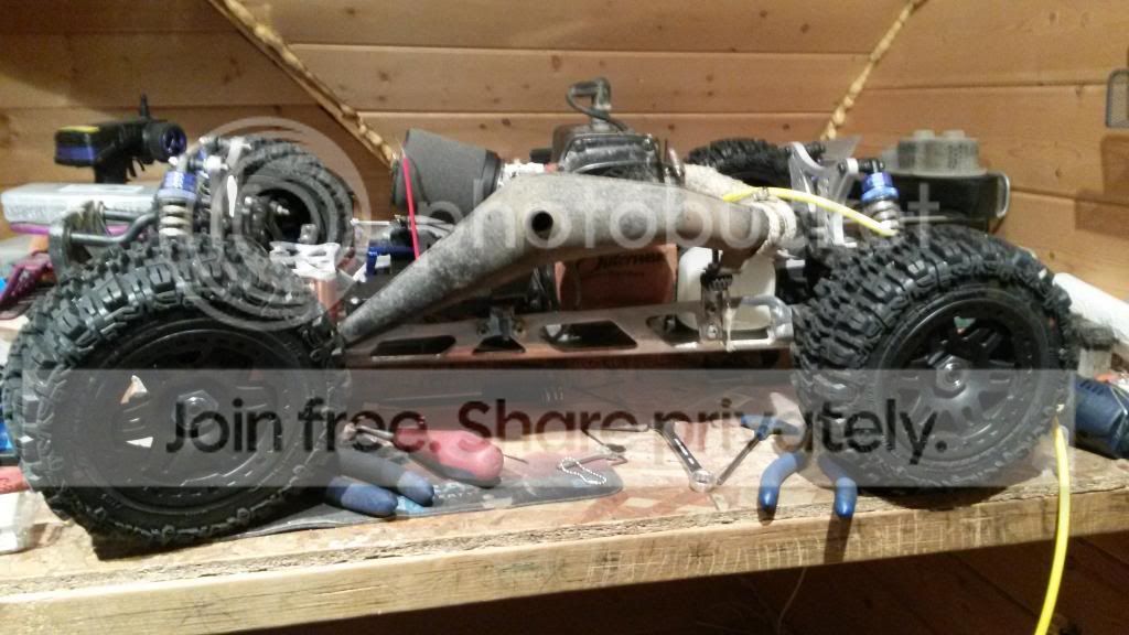

Been doing some upgrades over the winter on my mt. Done so far
- Killer Bee
- 8k clutch
- ddm dominator side
- wheel adapters with proline trenchers on split 6
- 813 carb. With chase filter
- HPI air filter with outerwear
- aluminum shread stack and intake

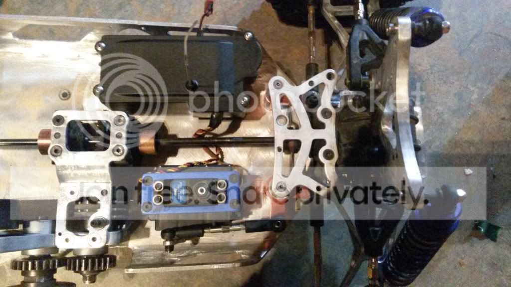

- single steering servo conversion with aluminum servo saver
- hitec 5805 steering servo
- mcd rear dog bones
- killer rc pull start with outerwear
- cvd boots on fronts
- some aluminum suspension components.
- Flysky GT3B
I will be doing some more to it in the future.

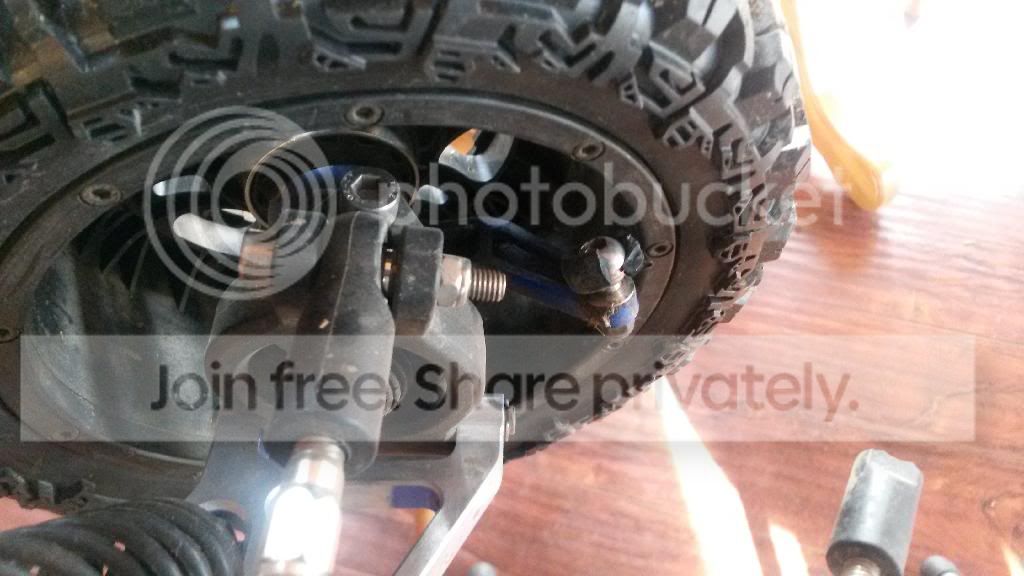

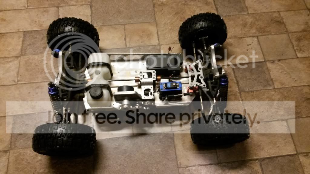

I'm getting parts in do the same thing, how do you switch to single steering servo? I figured the weather been so cold mights
All you have to do is get the servo and mount it if you get the redcat aluminum servo mount it is a direct fit. Then what is nice you can get the single servo battery box which is much larger! I just cut the steering saver arm off the left side if you want to use the stock servo saver setup
If I remember correctly I had to use the bushings out of my stock servo saver, my aluminum one didnt come with any.
That is correct. The posts and bushings don't come with it.

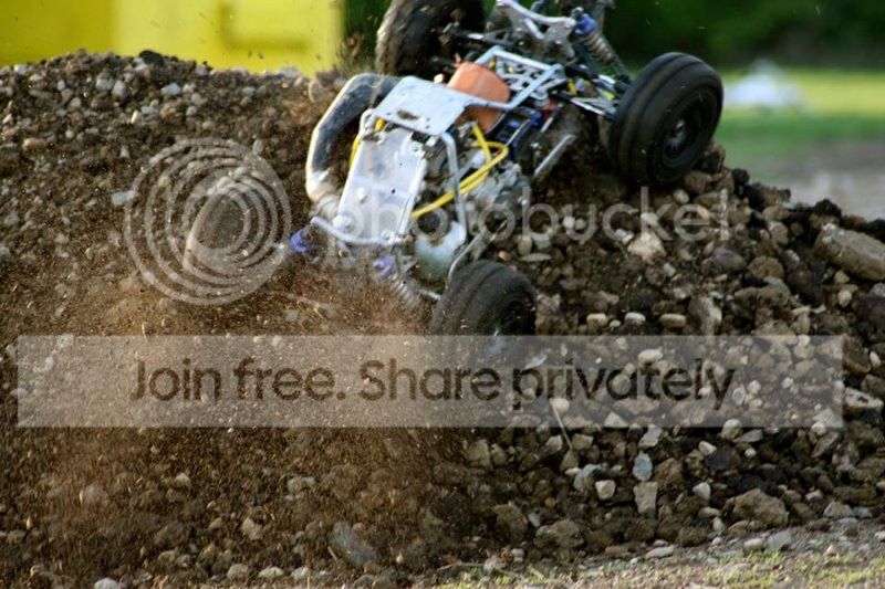

Hit a frozen hay bale. Probably good there is a week point so I don't damage the steer servo.
