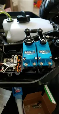

Are you using stock radio or?Mine did not steer like it should. I put the hitec d845wp servos in it and it is crazy the difference and how responsive it is. Way better than factory. View attachment 45118
