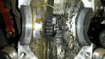

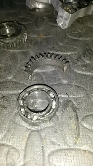

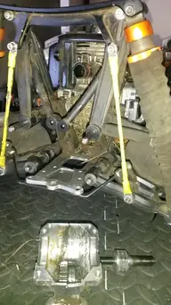

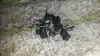

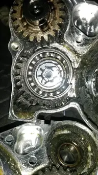

yes..it runs a turtle quik diff case...means diff out in only 10 mins....8 bolts/screws.....not the entire bak end in bits....I got flm drive shafts....newer 25mm cups..its started life as a 2014 5b ss 26ss kit......so comes with chunkier drive line......stock diff internals....I jus had a major gear fail last wk end..20160830_170145_zpssi8zjofu.webp
2 teeth missing on ring gear

Was all the damage to the diff from regular bashing, or were you beating the baja on insane jumps, and pushing it to the limits?
Those are KM diff gears?

Thats some money in that Baja. What I am curious is if this was premature failure doing regular bashing, or if this happened to you after some beatdown to the Baja doing high jumps, pushing the baja to its limits...
I do appreciate you sharing those pictures, maybe you had them in another thread and I missed them.
