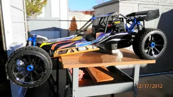

Picture of my Dune RunnerFirst thing I did was move the receiver on/off switch to the side. :)
/monthly_2012_12/PC170018.jpg.4dfb25195cdb150db2223d4dd76d3dc2.jpg
Nice job relocating the switch that's what I am wanting to do but I got mesh on the sides of mine!!! Looks good dude
