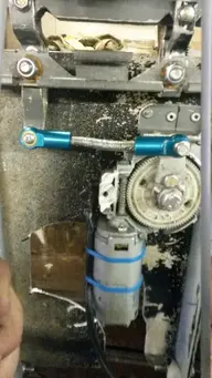

Steering is almost done 20150823_170636.webp just need to find a place for the potentiometer and the steering is finished then I'll be on with the throttle/brake servo.
