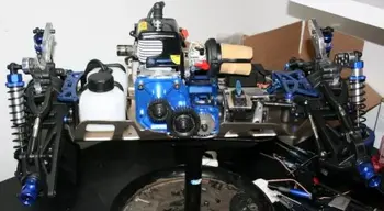

I am just about finished with my Rampage MT build. I thought I would share some of my upgrades and mods I did. I noticed a lot of people here went with a dual steering servo upgrade, so I decided to come up with my version. Decided the stock roll cage was useless, so I new I would have to make a new one of those. I made some custom shock towers so I could have a rear exit exhaust and a buggy body that could go through the front shock tower so it didn’t need to be cut. I also installed an alloy gear carrier, alloy center diff support, Ramtech C&D gears, alloy front chassis support, front CVD’s, and the Rampage upgrade kit. I didn’t do anything with the shocks, I will deal with those when or if I break them. Now all I need to do is test a few pipes and get the new MCD truck body when it becomes available.
View attachment 675View attachment 676View attachment 677
View attachment 678View attachment 679
Here are some more pics of the dual steering servo. View attachment 680View attachment 681View attachment 682View attachment 683View attachment 684
