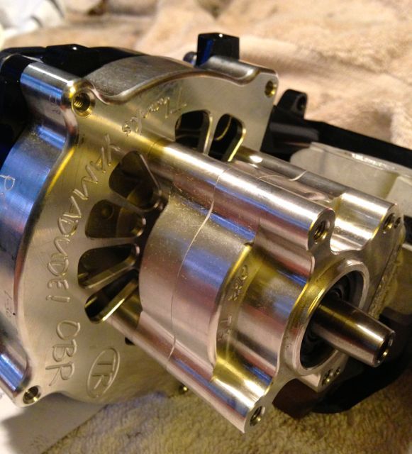

fresh goods obr zenoah 30.5 prostock 5.5hp
the mill is a zenoah 30.5cc head/piston/rod /crank
OBR custom billet case

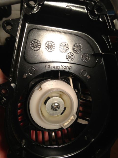

CY flywheel cover with obr stickers on it(stamped on the inside)
zenoah head shroud
no clutch housing/no clutch (had all that junk)
billet case

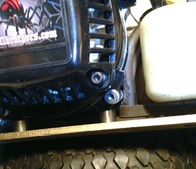

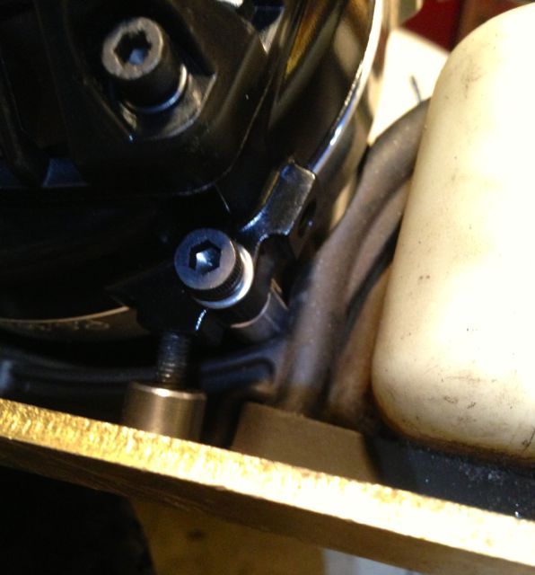

ITS A CY COVER that came on it
contact with gas tank mount
the altered tank mount

i selected NO CLUTCH, add 990 and thats it.
clutch/black or chrome covers/ carb are the choices
the billet is their standard issue hardware with ALL now as i see it.
the CY cover was a surprise.
with the billet case on the XB its a small issue but present. the billet cases are fairly new standard thing for them since summer/fall '13 i think. so heres to discovery.
i just clipped it off and "impatiently" hacked it out of the way. seems quite minor but should be in the knowledge base.

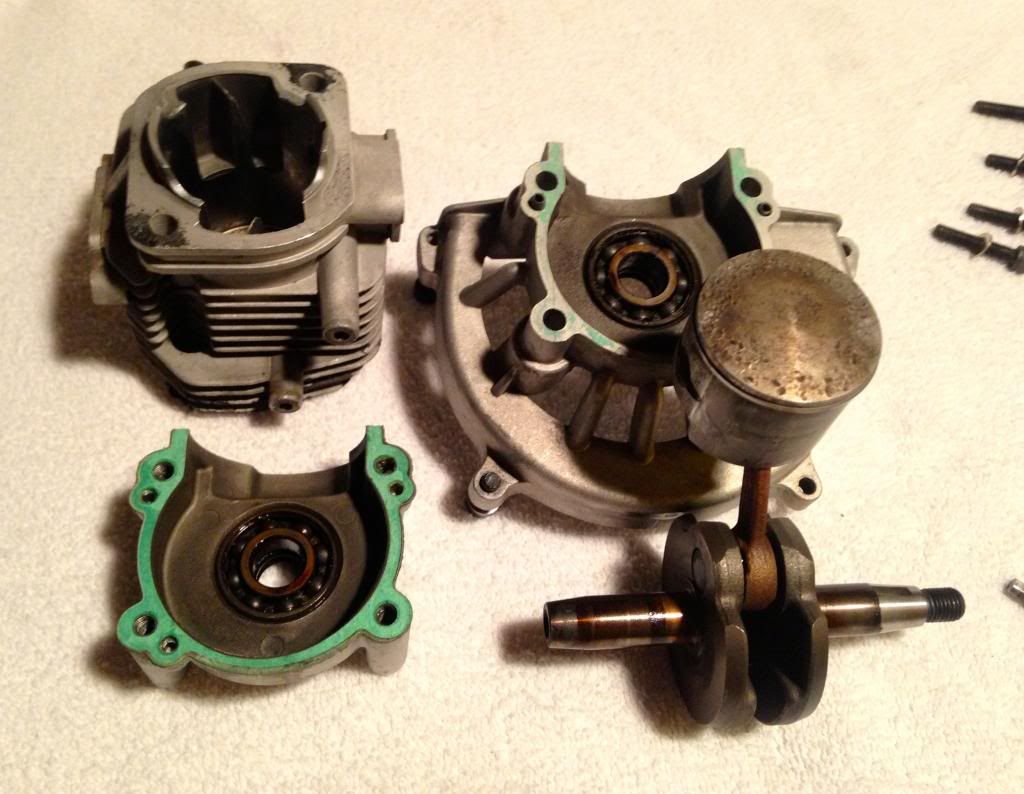

time to rework old motor, 2 bolt race ported 30.5 coming...but first the remains.

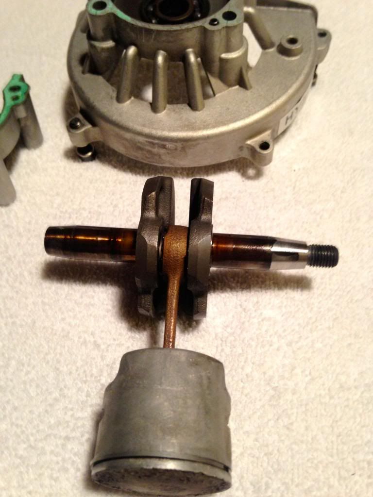

this stock HY 30.5 cc covered about 300hours of use , compression dropped off, overheating, a few fried clutches... and thats what you get, add a nice sand diet, couple wrist pin cage parts, maybe a rock, and crank is surely roasted even some plating is gone.
so the fresh parts, a race ported head CY looks to be a decent choice , rod stroke +2mm and crank stuffed as well. can't wait ...for a great roller chassis to come along to put it in!

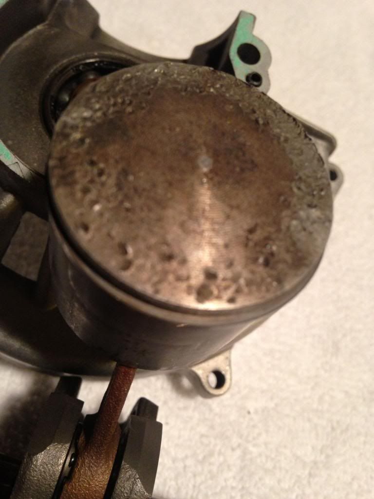

heres a piston with 300hours from old stock HY 30.5cc

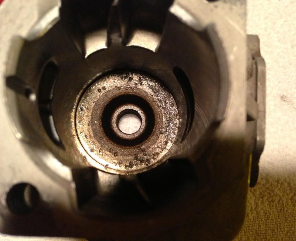

and the cylinder dome
i checked for carbon on top of the piston at about 200hours. it had some carbon stacked up but did not look like this! once the carbon breaks loss anything goes. and the wrist pin bearing cage was fractured pretty good. the bearings in the case seem solid. looks like they got hot they will at least get fresh seals.... anyway the 2bolt stroked ,stuffed and race ported set up should be fun.
