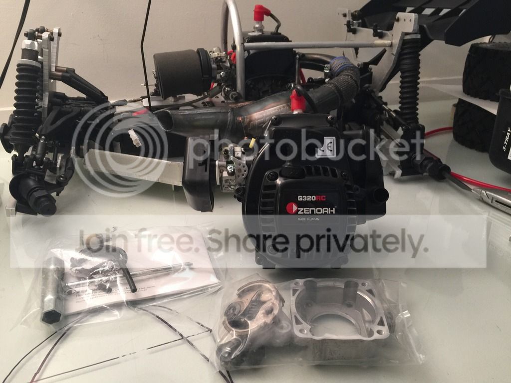

We got a little break from the weather. But guess what, the pullstart gives up on the day I could actually run it. Ordered a new one, better rope, aluminum pawl. I can't use the TR pullstart due to clearance with side pipe. Was supposed to be delivered yesterday so I can try today, but nope USPS got it delayed. LOL!

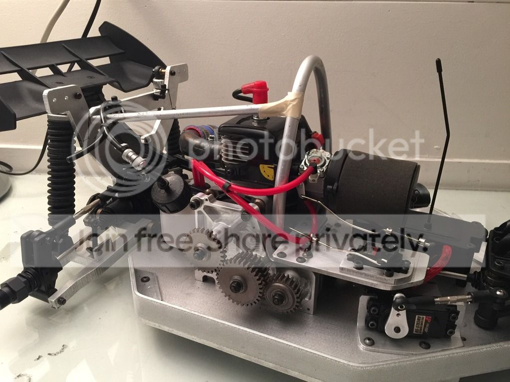

Oh well, at least I got to start working on the roll cage.
Thank Pheerider! Since I didn't receive the 9500 rpm, I'll be using the 8k spring from my 30.5 for now.
On a side note, I'm debating if I should have a second loop behind the spark plug on the roll cage.
I did and the top of the central hoop and the top of the rear tower are both above the spark plug, protecting it. I was just worried about the buggy landing first on the space between those two points. May be I'll run a bar between the center of the hoop and the center of the rear tower or just leave it the way it is.
