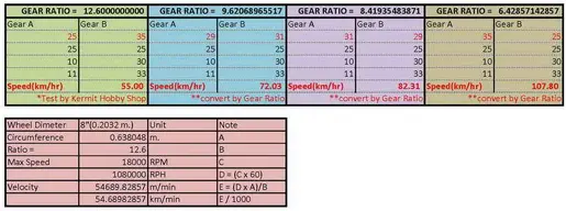

Dear Both
sorry reply late, i have some problem with internet.
- The Motor are CY engine 27 cc 4 bolt give 3.5 HP... about 210USD...
- That filter from Motor in HURRAX i need to show the Racing clutch....
