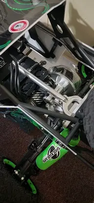

I'm running hobbywing 650kv with 18x57 with a max 5 gs2 12s and it's plenty fast if the motor your talking about is the hobbywing 70mm big can I don't think it will fit on a vesla as clearance with rear brace might be a issue a vekta you can pit in 70mm hobbywing motor max 4 will be big on vesla but you can make it work this is what I'm running

You will need the electric motor mount I belive that's all you need $50 for stock $110 for light weight billet version
Max4 / 560kv in a Vesla would be an animal - I’ve got the max5 g2 / 650kv and on punch level 1 with turbo timing at 0 it’s ridiculous :)
800kv will get warm depending on gearing - get the twin fan system via Kraken - they’re powerful & work very well
