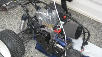

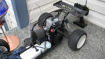

heres my new 26cc engine for the T-bolt
I'm trying a 813 carb
The 813 worked great on my 23cc engine, but as soon as I put one on my 29cc engine I could never get it tuned properly....I don't like them.

the spark plug is alot taller than stock you cant use it unless you take off the spark plug guard/cover:no:
The "no choke" is a pain in the butt....a bugger to start!

So I figured out the jingly sound......
the steel pinion/gear on the clutch bell has play in it....mabey the clutch bell carriers bearings are toast
the gear is secured to the clutch bell shaft by 2 grub screws but still has side to side movement...The buggies only seen 4 tanks of gas.....
heres a short clip of the movement..... http://www.youtube.com/watch?v=d6wcXIJhGuw
Any of you dealers that have in stock a Smartech Titan...could you look to see if your gear on the cluch shaft has play...It might be a issue that smartech is not aware of?? All their 4x4 have this jingle.
Wow, that is some play. Does it seem as much as it looks on the video. Not sure how the shafts are fitted but it looks like the shaft is moving too?
your right BTB the center clutch bell shaft is moving as you can see in the video
the gear is mounted with 2 grubs to that shaft just like any other 1/5... yep alot of play
the clutch bell is a vented one ...thats a plus..... The stock motor is not a Zenoha or a CY
so i installed my new engine & I used the hpi clutch and 8000rpm spring and reinstalled the stock clutch carrier and bell
now the play is less(but there is still play) and the jingle is almost gone:blush: didnt use the 813
