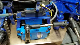

20180616_175233.webpYes Sir the Hitec d845wp fits right in there. I had to put a few washers under the Savox 1210 throttle servo mount tabs beings it's so tall
