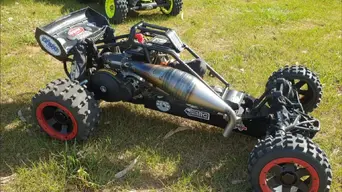

Obr Baja pipe
Wonder if the bottom end will suffer? Looking for snappy bottom end with good revs but aren’t we all.?.?. You would think with the bigger stinger you would lose back pressure resulting in loss of low end grunt.
I have a bizeta pipe for the bajs but it was designed around the 28.5. Ordered a obr 34 reed. Planning on using 19/55 gearing.
