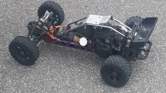

Hey guys,
I'm looking for a cage for my Baja and the only one I think will work is the Rovan Sand rail since it has a taller rear section to clear the exhaust. I have the CPI exhaust with loops in the back as high as the ignition wire. From the looks of it, it won't clear cages like the Triton or Class 1 buggies. Any other options? I had the Rovan sandrail before on my Baja flux, but the cage is metal and pretty heavy. I'm looking for something cheaper this time around and lighter too. A plastic cage with a lexan body panel would be nice.
Pic of my current Baja and pic of my old Baja flux (with Rovan sandrail cage) which is sold now. I wish I kept the cage on that.

Did you try reseaching Chase cages ?
Just checked it out. It won't really work as it's for a 5T/5SC. That's not really worth the effort since I'll need to convert the parts, then buy the cage. It also doesn't have any body panels which is a bit ugly imo. The cage will definitely clear the exhaust though.
I was looking at this one from King Motor. The rear I don't think will clear the exhaust pipe, but I guess the plastic doesn't offer much in terms of chassis stiffening anyways. I could always dremel off the top rear of the cage pieces.
