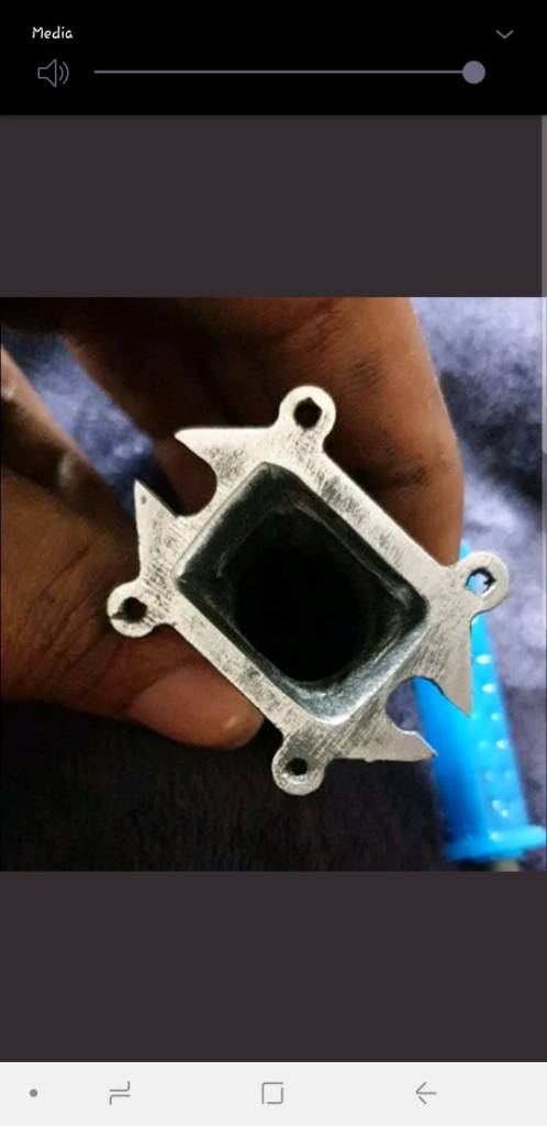

I modified my samba pipe for my 45cc works like it was made for it no issues at all not even a leak 100% matched to the portdoes anybody looking to get a rovan 45cc engine or already had one? I'm thinking to get one but there are so little pipes opinion. As far as I know the 45cc engine has different port size, normal pipes don't fit.
It was the samba bigbelly the header seems to be alloy instead of steel easy to machineCan you tell me which samba pipe your using?
Just gotta modify the header widen it it will be fineOk I have a 45CC on my baja and i'm about to get one for my FG sportsline and I really want pipes for both of them.
Or buy 45cc gaskets from Ebay they fit the rovan port* and gasket...
