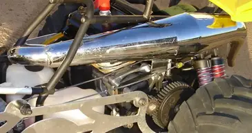

I just got my DDM dominator pipe. I have the FG competition MT with mechanical brakes.
The rear brakes have a plastic carrier which joins the cable linkage and this is getting in the way of screwing in the pipe which uses the same bolt.
Does any1 have a solution to this problem???
Would a jetpro pipe offer a better fit?
Ok, you see where your SIDE MOUNT Screw is? Well I have my REAR Mechanical brake coupler there and its getting in the way.
you see, that plastic carrier which couples the 2 rear brake cables is NOT allowing me to line up the rear bracket of the pipe. =(
AND i cant move the plastic brake coupling to the front because the brake cables are not long enough.
UPDATE!!! After hours of work, i finally figured out how to install the DDM pipe.
Basically, I took the rear brake plastic coupler and turned it 180 degrees around. Look at the previous pictures I posted in the previous post to see exactly what I mean.
I still need to "expland" the hole in the DDM pipe but I will do that tomorrow. Otherwise, the pipe fits perfectly and has good clearance with the rear shock tower.

Great work with the 'inspired obvious' thought of 180'ing the cable mount.
I had the same problem.
I didn't go ahead as I was worried about being too close to the throttle bar - any problems here?
Alan.
Alan,
The throtle linkage and the brake are close to each other in this "modified setup" but they do not touch or interfier each other. I had to "Re-bend" the metal linkage wires but that was it.
UPDATE: Installation of DDM Dominator Top end pipe is complete and went smoothly without much complications once I figured out how to modify the rear brake cable linkage. I am including some pix of the mods that I had to do in order to make things "fit".
Overall conclusion: DDM Dominator pipe definatly LOOKs & FEELs nicer and has a solid contruction compared to the stock FG Competition pipe.
