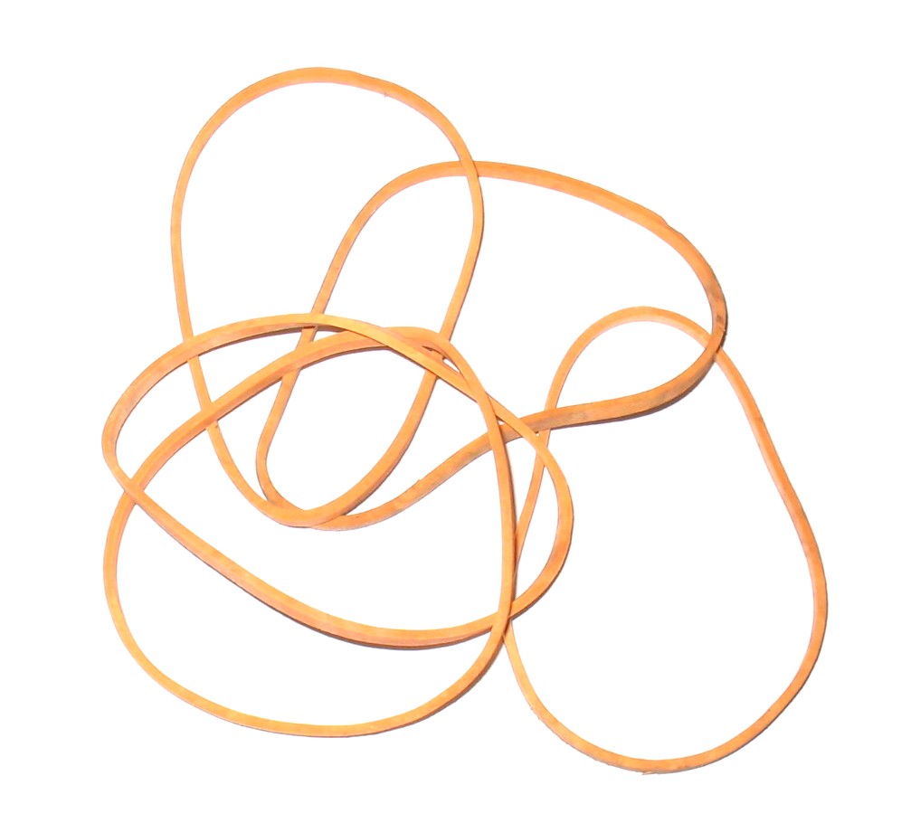

If you want to avoid killswitch gremlin issues. 2 of these can replace it.
