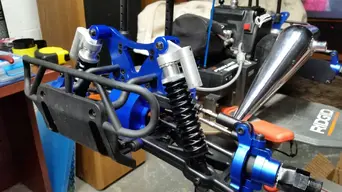

That looks good man, I would really like to get aluminum hub carriers and Knuckles for the front of my chimera but everything out there seems to be 4 version 1 they all look like they share the same Parts I'm just wondering if the Hub carriers that are for the Mt and dunerunner fit the Chimera since they are practically all X SeriesI totally agree with @Dusty ! The regular MT is the way to go. Put aluminum diff housings on it, which the pro doesn't have. Also the diffs need shimmed bad.Leave the arms and steering links plastic. Put aluminum servo saver, steering knuckles and bearing carriers it holds up well. I just put the piggyback shocks front and rear 50w front 60w rear. They are noticably different in performance when jumping.View attachment 14081
