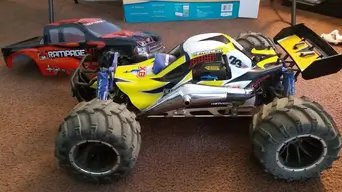

Update on my MT to TT conversion.
Received some parts in... Have a look20170331_173640.webp 20170331_214243.webp took some doing, the wing parts do not come with screws so off to the local ACE hardware store for all the screws i needed.
Have the wheel adapters for a set of Rovan Knobby rear tires but im going to stick with the MT tires for now.
Just finished installing the Stern Belt drive
Cant wait to take her out!!!
@SmokinToad Good job on both mods.
Perso, if you going to have the wing on, I would use regular tires. The MT tires make the wing look very small or awkward. A buggy body would also help the look.
Again good job an the moods!

Reinstall the front mounts and raise the rear mounts, and just take the wing off and the wing mount will fit right under the body

I have the mt pro and run it without the body a lot because it looks good and I have destroyed the body already. Do you mind to list all the parts you had to get to do this? And also is there any permanent modifications that you have to do or is it all Bolt on stuff? It looks like from the pictures. All you got was the wing mount and just took the front mounts off like you were saying and lowered the rear.
From what I can find the wing mounts are 51007 and 51008. The wing is 51009 but I can't find a xb body that has the shape of that one unless I'm just looking at it differently. Are all these parts the ones you used? Also what body did you end up going with? Thanks for the great idea!! I have been wanting to do this since I busted up my mt body but didn't find much on doing it.
Well after looking at your body closely I realized you have the maverick blackout xb body and wing. I can only find these at a few locations online in England. Where did you purchase yours? Thanks.

I ordered my body from the UK. There was an untrimmed clear body for $100 but the lead time on it was more than 1 month. It is a maverick Blackout xb body. The one I purchased was the stock body that comes painted but it's the only body that comes with the top still on it

Ive found some of the only "TT" bodys available. The only thing is... they are HPI blackout XB bodies. There is 1 clear untrimmed body on EBay but the shipping time is longer than the return policy for about $65 with $30 S/H. They have painted ones that are the stock HPI Blackout XB bodies for $100 that have a lead time of about 1 week. the HPI Maverick Blackout MT/XB/ST are identical to the MT/TT. you can still find wing mount, wing, wing holders, and front bumper for the TT @ redcatracingtoys.com. Just ordered the parts from them for about $55. cant wait for them to come in. the part # for the body is MV24187
The wing mount doesn't come with hardware and you have to get a little creative with the top location of the wing mount. Just a longer screw from the oposite direction. I found all the hardware from my local ACE hardware store.
