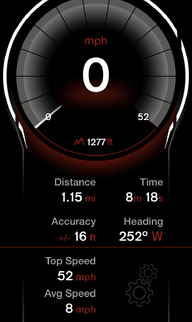

I’d say maybe he had the 35-25 gears but you say same gears 31-29 (for top speed). Really I feel like mine will push to 50 with the 35-25 because that gearing ratio change seems pretty big. but with the 31-29 I did 3 runs with my phone gps speed app tucked in the body, which seemed really accurate. as I drive my car it stays within with 1 mph of my speedometer. I got 41 on the first one in the buggy and couldn’t beat it the next two times. However even if the gears are the same bigger tires should significantly change the math on the top speed no doubt. My stock tires are also pretty soft and might cause some resistance, I could really do better than them but I do love the look and off roading. Maybe I’ll look into adapters. My rear differential has a very slight resistance point between the pinion but I’d think that would be 1-2mph at worst. I have to say though I get to 41 very quick and i love the torque. In the video and as always I ease into it before I go WOT on the street because it will kick the rear end out real good and probably tear the tires up. I did have one person say he thought it looked like 50 in person, but I feel like 41 is about right. With gears or tires or both I feel like 50 is in reach or damn close. I may order a 35 soon just to try, I wonder if I’ll still be doing donuts in the dirt with it, I have a feeling it will still do better donuts than the original engine with 29-31 gears lol. I wonder what else is if anything is different about that Xt/ engine, maybe it revs higher for more top speed, I’m not sure. My #6020 prostock peaks at 13650 5.47hp and 2.11 torque
Just installed the 35-25 gears and GPS app gave me a 52mph top speed. Buggy can still drift around in the dirt though the 31-29 are better for doing that377DC43B-C9DA-4797-B205-E12ECEC31AEF.webp
