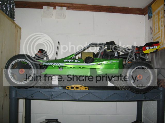

And here is my car just to show it off. I have a Pro-Line Desert Rat body on it and a Pro-Line Undertray. Gotta love the Lime Ice paintjob.
