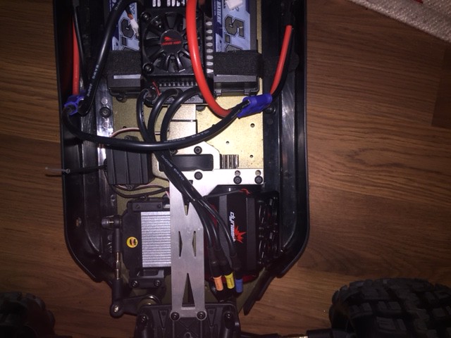

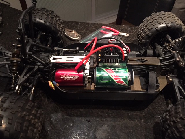

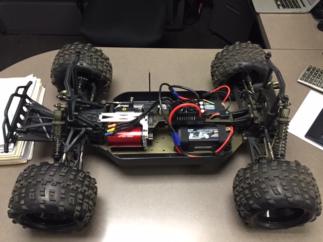

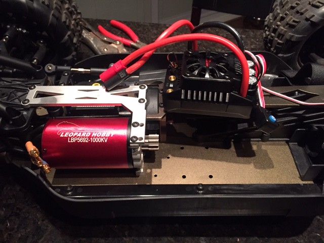

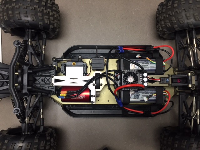

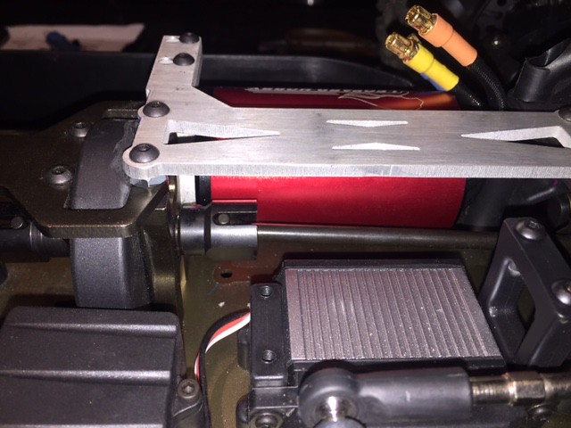

Here's my new Redcat Rampage XT-E with a Kershaw Designs motor mount, Leopard 5692 1000KV motor with 10t pinion (41 spur), Hobbywing Max5 200a ESC, 8s powered (two 4s lipos in series).
I haven't run it yet, will start testing tonight :)
Thanks for all the knowledgable people on this forum!

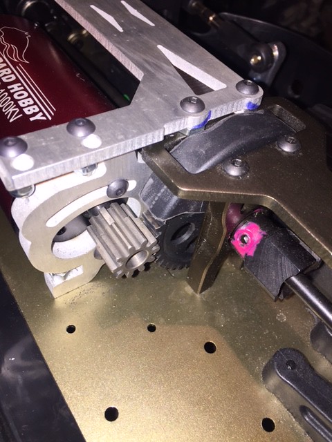

Thats a bummer. My dealings have been good with Dan, but I will most likely be upgrading to the 7075 mount when available. The Kershaw Designs mount gets the job done, but I had to work through a couple issues like how to retain the spur gear cover to keep the rear aluminum chassis brace level or what spacers to use to keep the new motor mount brace level from the front bulkhead to center spur gear mount.
It all worked out in the end and it was a fun project for me.

On your stock ESC what were the battery connector types? XT-60? Would like to know this when i buy new batteries for the XTE - thanks
Nice set-up! How do you like the motor and ESC so far?

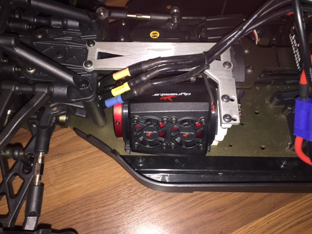

Was the motor fan really necessary? What motor temp did you run at?
I love the motor and ESC. The ESC was literally plug and play (no setup necessary, no issues, no spark when plugging in lipos, flawless, plus the packaging and the fact that its waterproof rocks).
The motor is a powerhouse. In the back of my mind I would like to try a 5698 835kv, but then I would lose some of the ludicrous speed and the truck already has enough torque to blow the tires off at low RPM's.
The temps measured before fans were 80-90 degrees fahrenheit, but I'm in the dead of winter, so I was anticipating the temps to go up in the summer, but the fan is probably overkill.

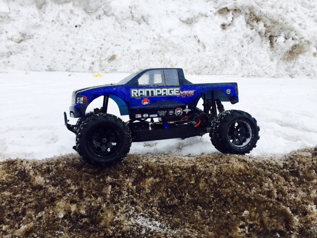

Heres a little testing i did yesterday. Cant hold the throttle for more than a few seconds, It jumps really nice at the end, easy to correct the level of the truck in the air.
Very happy with the truck.

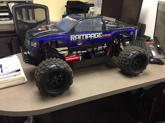

I took mine out today and i lost 3 body clips right off the bat , had trouble with the front body clips fitting correctly because the body wouldnt go down far enough on the posts to push the clips through - did you have the same problem?
DougSeger,
I've got the same issue. I raised up the front body posts (leveled the body front to rear) so i can bend them forward with my hand when installing or removing the front body clips.
