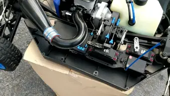

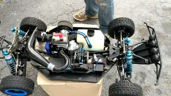

Its almost ready for the break in. Ordered a Losi tuned pipe yesterday and a battery charger. Need to get a kill switch, air filter and a couple other things.
Received my Pipe yesterday and battery charger. Was able to get 4 heat cycles on the engine before it ran out of gas and was unable to get it started again. I believe i flooded? couldn't even get a pop or anything, so I'm getting a new plug today and going to mix some castor 927 up instead of what i was using.
