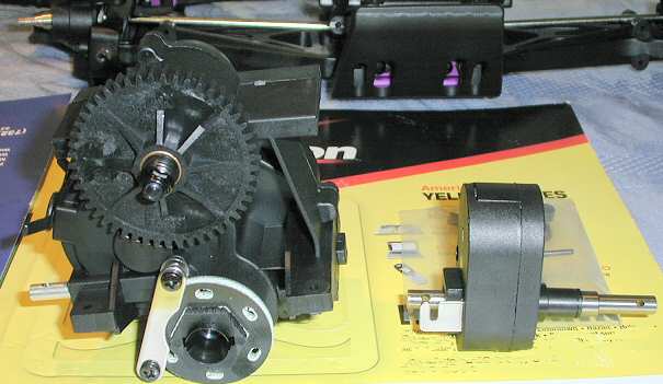

What model has this sliding gear?
HPI Savage, its a separate module taht has to be installed inside the existing gearbox of the MT..
Rob your BL motor idea is actually great and feasible, no load at all even when coupled directly... gear, belt or shaft.
I think that's a great idea... I just need to think how to couple it to the drivetrain
we can attach pulley to any diff gear's axle and install motor above,than connect by belt.

I was thinking about using the same exact gear that goes 90 degrees into the center drives. I haven;t read a manual in a long time, but add another gear opposite the brakes,
RampageHopUps said:
Yes, I agree for the home made versions, the pulleys are easier. For a machine shop version, the gear would certainly be cheaper. If it rains this weekend, I will fool around with some ideas.
