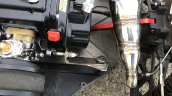

Is that a spring under that lock nut on the motor? Where that L bracket is. If thats a spring and you collapsed it thst removes any vibration dampening it could have provided. Just a thought.The photo was taken the other day. This is a supporting post, but some of them were broken when connected to the engine.

Do you a picture of how it mounts to the cylinder?The photo was taken the other day. This is a supporting post, but some of them were broken when connected to the engine.
And there is the problem.This is the exhaust he has, it's solid with no coupling.

Yep.Not to mention it's hard mounted on 2 ends and doesn't let expansion of the metal to happen.
