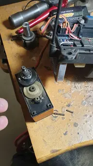

So out of the blue my servo got an issue
On my 65 build anyway I got lucky and managed to fix it what confused me was savox used a combo of brass and steel for the gears the one I repaired was a brass one that had a steel gear pressed in to it the set next to it is steel with a steel gear pressed in so in the end I just repaired it with a center punch got the gear in and used the punch to splay the the brass now I'm ready for action
