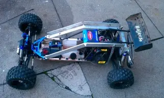

Hi, just wanted to share my roll cage idea, a bit ugly yes, but already saved my dunerunner to get in pieces.

here are the pics... :rolleyes:

yup ugly but works. u can order 4130 crommolly tubing from amazon.com believe it or not lol.
72 inches delivered for like 20 bucks. get maybe 5/16 thin wall and give it a go.
whats ugly is not your work but the material u used:-)
Good idea not too pretty but it looks like it will work im planning on making a cage for my tt and im gonna make the front come down like yours .
thanks for comment;), I'm not really worry about how it looks, but has u guys know, the frame has to much flexibility, specially in the engine area, what makes impossible to brace a rear pipe at the rear end. ;)
