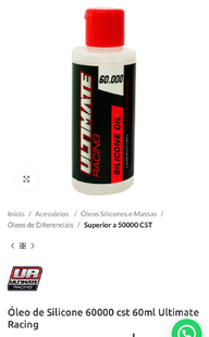

In diff oil I find the acronyms CST and CPS but I can't find information about the differences... it's just that in some stores I find 50,000 cps and others 60,000 cst...
