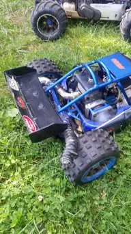

I am looking for ideas of upgraded shocks. I broke the shaft of one of my stock rear shocks on my DR jumping today. Wondering what other brands may fit and work better? Thanks
They seem to be very close in length. Wonder if anybody tried them. I found a set of 4 rovan Fite the baja 5b etc for 80 bucks. Will try, if they won't work (which I think they will) send them back.What's the length of the dunnerunner shock? It may be the same or close to the Baja 5B shock length. Something to think about.
http://m.ebay.com/itm/Alloy-8mm-Fro...%3A579b040915c0a86646840e6dfffd0a6d%7Ciid%3A2The Baja 5b front shock are shorter than the rear. They may be the right length. Rovan also has a 8mm shaft upgrade kit. I use them on my 5b shocks.
Ahhhh something like these. Thanks for the tip! I was looking at 6mm shocks before.The Baja 5b front shock are shorter than the rear. They may be the right length. Rovan also has a 8mm shaft upgrade kit. I use them on my 5b shocks.
I wonder about clearance with those shocks though.
