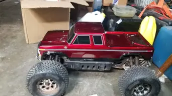

I've used it several times. Last was candy apple red, silver backer, then white and black as the final backer color. I didn't use spray bombs as I have an air brush. It takes more coats then you think. I used 3 bottles of the candy apple red, one and a half bottles of the silver metallic, half a bottle of white, and a full bottle of the black backer. Light coats are key with the color and silver metallic backer.
Thanks Bud, the finish on your truck looks really good 👍
Your truck looks like a 1/8 , I'll be painting a 1/5 scale short course truck body, so looks like I'll need at least 6 spray cans for the main colour, light coats are the way to go, specially with metallic,or your metallic sinks to the bottom of the coat, & looks like crap,
Yeah, it's a savage xl, so bit bigger then a normal sized 1/8. I was very happy with how it turned out. Pretty much nailed that classic candy apple red metallic look.
