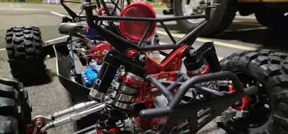

Just to clarify - you're not just using the front blue springs but the entire 5t shock on the rear right? I was looking at the I-RC front springs and thought about throwing that on the back, wasn't sure if it was a great idea.I am using losi 5T front blue springs on the rear of my dbxle. You have to bore out the openings on top and bottom just a bit for it to fit. No more sagging. The front I am using stock springs cranked down with thicker oil.
Front 659 cst oil
REAR 1000 cst oil
And also, which part did you specifically bore - the opening for the fastener which the spring sits on?I am using losi 5T front blue springs on the rear of my dbxle. You have to bore out the openings on top and bottom just a bit for it to fit. No more sagging. The front I am using stock springs cranked down with thicker oil.
Front 650 cst oil
REAR 1000 cst oil
These: https://www.innovative-rc.com/product_info.php?products_id=818I am only using the springs with the stock dbxle shocks. That's why you have to bore out the springs in order to fit.

Going to pick up heavier oil here in a bit. I appreciate your suggestions. Also my badlands mx57 just came in the other day, waiting for my hilatronics servo to come today so I can run em. Actually decided to buy the badlands because of on of your posts on a separate thread.Ahh ok complete shocks/spring assembly. Haven't tried the 5T shock on the dbxl but I don't see why it wouldn't work. If you are going to that route just a buy a complete front and rear original losi 5T 2.0 shocks as they are very high quality.
I used a Dremel to bore out the openings.

I bought the red 5T springs for my dbxl-e tried putting them on and the spring won't go pass tge thread in the shock. How did u get those springs on your dbxl-e.I am using losi 5T front blue springs on the rear of my dbxle. You have to bore out the openings on top and bottom just a bit for it to fit. No more sagging. The front I am using stock springs cranked down with thicker oil.
Front 650 cst oil
REAR 1000 cst oil
You have to bore out the spring with a DremelI bought the red 5T springs for my dbxl-e tried putting them on and the spring won't go pass tge thread in the shock. How did u get those springs on your dbxl-e.
