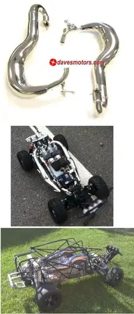

Hi everyone, I'm new on here and I can't find any information about this so I need some help.
I just bought a used Baja 5b and try to convert it to 5T. I try to order the roll cage made by Team Chase RC and don't know if this cage will fit my setup or not. I have a twin RCMK CR600B with JetPro Twin Exhaust.
Here are the pics of the cage and pipe. If anyone have the same setup please help. Thanks

ive seen twins and tc cages used together with v1 and v2 jetpro pipes.from a 5b you will need front, rear and side mounts.
the tc cage for me is upthere will the killswitch for safety purposes.
did you buy the baja with twin rcmk installed? nice motor that can be upgraded with obr heads if wanted.
