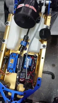

Cool. Will have to keep that in mind. maybe upgrade drive line. Someone said they have a 1 piece. I really dislike that off set going to the front diff
A straight driveline would be sweet huh. That angle is pretty bad. I think there is power loss there in my opinion. I upgraded the servo and mount. I had to slightly notch the servo mount for the center dogbone to clear it. Although it still nips it on heavy throttle, see a small mark on the shaft. But as far as the current DR there are plenty of things available to upgrade it. I recently installed the aluminum diff housings and belt drive like @Phill uses. The rig seems pretty solid now minus the center shaft deal you guys were talking about. DGI makes steering links for the MT that are aluminum with steel pivot balls and rod ends that would work on the DR. My major issue is the steering servo saver rack. Too much slop or play whatever you'd like to call it for my liking. 7075rc makes a rack for the X-Series that is also single servo steering. I do not have a XT to compare the width between the two posts etc to see if it is the same as the DR and MT. By looking at pictures it may work. That would be an expensive trial and error there which has led me to using stock Redcat at this time. Maybe some of you guys have an opinion on trying that rack in the DR?
I modified mine so it is straight a long time ago. Would like to say it made a difference but
I did several drive line mods at once. Turned center bearing carrier and shimmed square heads for gears. Aluminum foil and locktite. Gears bound and had tight spots. Rolls much smoother.

I may try to center mine too. Here is what I was talking about20170429_203618.webp

Did you have to change dog bones?
If so what did you use?
Thanks
