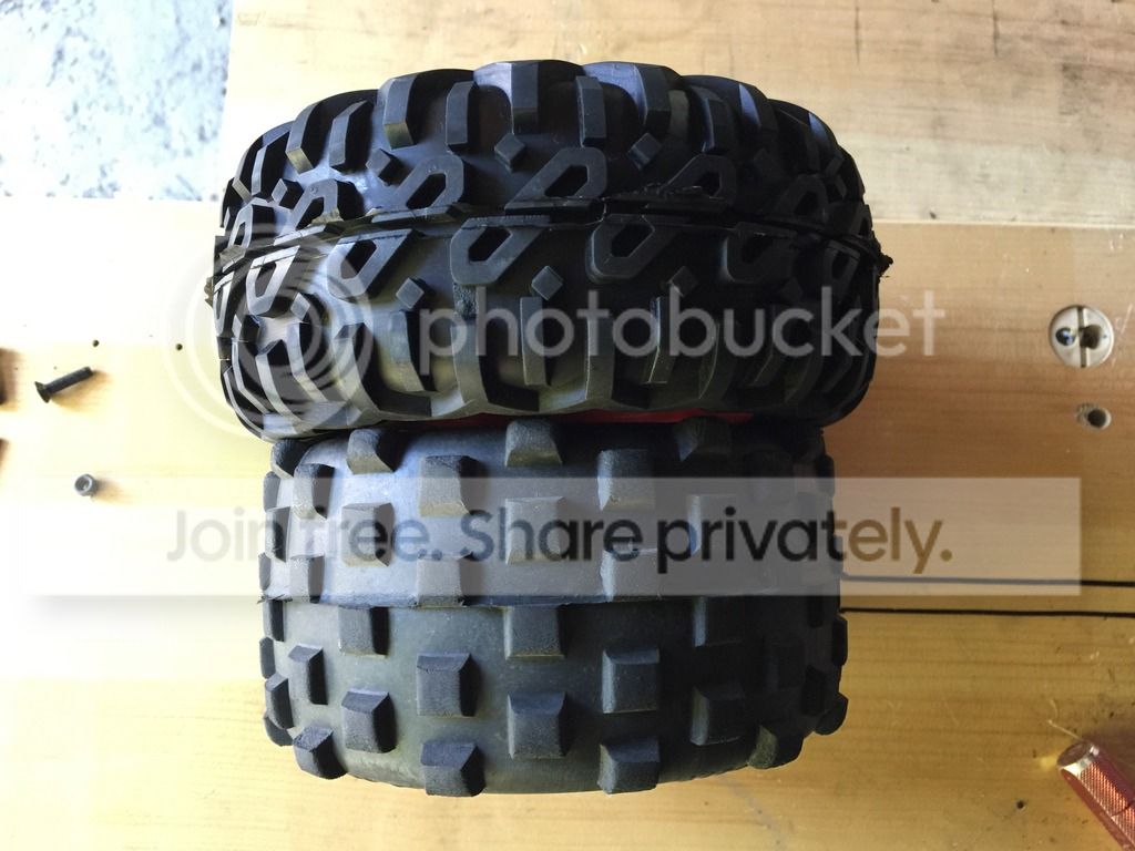

1- Out of the three linked tires only the bowties are for 5B rear.
2- Crushers and trenchers are for 5T only.
3- Tarmac rear are for 5B only.
4- Rear 5T Trenchers and crushers are 5mm narrower than rear 5B Tarmac so you won't have the same look as with the tarmac should you go 5t tires.
5- You can run 5T rear tires on 5B rear rims (makes them look wider) with rear foam. Do not use front foam on 5b rear rims, they will not fill the tire/rim. Base on my personal and very recent experience the 5T front foam insert are too skinny when used with rear 5t tires.
6- Trenchers rear tires won't work with front rims regardless of front or rear foam insert used. Beadlocks won't secure/hold them safely to the rims.
7- No you can't use your rear foam insert. 5T tires are taller than 5B tires therefore 5B foam inserts are not tall enough.
8 and most important: once you add asphalt to the equation, you will not going to find that tire that will last on it and perform on other terrain at the same time. It's one way or the other. On asphalt Crushers will last longer than trenchers but trenchers are grippier. On asphalt, stick with asphalt tires only. Worst get slicks as even those road advertised tires like your tarmacs do not last.
Best solution====> So get a set of slicks and a second set of tires for whatever other terrain you want to drive on.
But it's your decision and I can at least provide you with some info and pics.

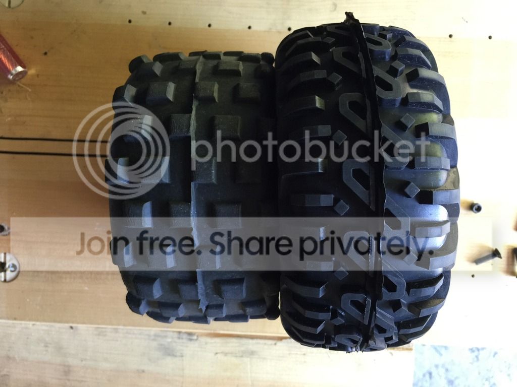

Crushers 5T rear vs Hostile nightmares 5B Rear

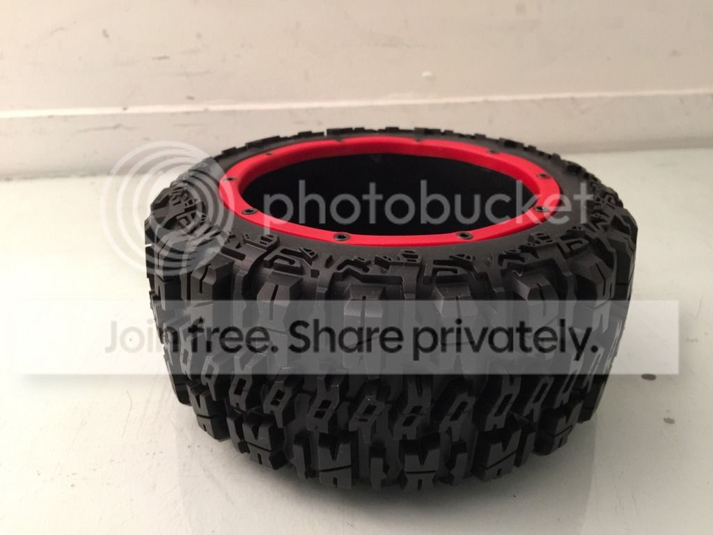

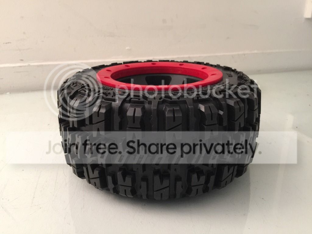

- Proline trencher 5T rear
- Hostile zero growth 5T rear
- 5B rear rims

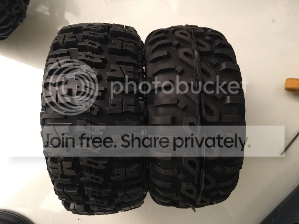

Trenchers vs Crushers:
How they look mounted
All of this info and may be more came from my build. I tried to pull the most pertinent ones but feel free to check it in case I forgot something.
