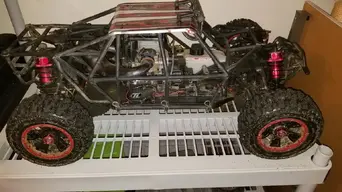

If i remember right, the first time i did them it was a little bit of a pita... I'm pretty sure i either wrapped the foam or the inside of the tire (maybe both) with gorilla tape. I can take one off later to take a look. The DBXL aint gonna be runnin' for a little while.....20171020_223040.webp
If i remember right, the first time i did them it was a little bit of a pita... I'm pretty sure i either wrapped the foam or the inside of the tire (maybe both) with gorilla tape. I can take one off later to take a look. The DBXL aint gonna be runnin' for a little while.....View attachment 46101

Went to the garage...pulled off a wheel...
I gorilla taped the inside of the tire and the foam.

Oh ok I actually got home from out of town early Sunday so I put the trenchers on. I only taped the foam though maybe later I’ll take them apart and tape the tire also. Thanks for the input.
The stock foams in my dbxl are crap. I taped them to hold the form better...stop ballooning.
One of my frinds said i should tape my tires to help stop them from doing the pizza cutter thing....althoigh i don't think the gearing with 4 bolt 29cc chung yang i had in it has the tourqe or rpms to do that....but i did it anyway...i had them off so they got taped.
If you really want to go hard core, you can balance the tires.
