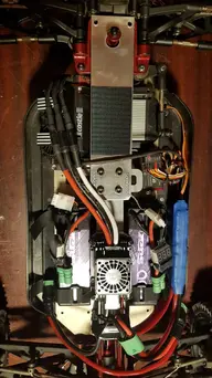

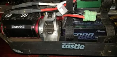

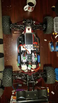

It bolts right in....unless the motor is too big. I had to shift it 4mm towards the rear to fit my choice of motor. Here is part of the listing I put on kijiji:
Top of the line motor (Leopard Hobby 58110) with dual Castle cooling fans and ESC (Mamba XLX). 8S powerhouse. gensacearespammers batteries. Custom made 28000 mf cap pack. Aluminum upgrades. Modified chassis. 7075 motor mount. 4 wheel drive. Baja 5b axle adapters for 5b wheels and tires. Baja 5b shocks
Castle 2028 fits easily. I just had the Leopard available immediately, 8n stock at the hobby store.
Needs an aftermarket spur. I'm running an 18 tooth MOD 1.5 spur. Torque monster. Cant keep the rubber on the wheels when hot dogging on asphalt. Blows the beads apart. Gotta glue them as well as bead seals.
Made the front aluminum brace between the front diff and motor mount. It reinforces the chassis, beautifully.

You'll need a good esc...Castle would be much choice. The downloadable data is very informative. The castle 2028 motor will fit. I don't remember where I ordered the spur gear from. But as long as it is a MOD 1.5 spur gear, from 14-18 teeth, it will work. 8mm bore. Locks on with the provided grub screw. Google will find these parts online

The only dimension of the motor that is important here, is the length. Measure the space between the cam and the steering pivot. That motor fits, if I remember...Best for you to check yourself.
