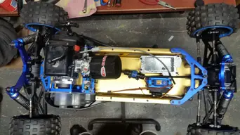

Well for those who may do this to their DR steering. I purchased a hitec d845wp servo and the Futaba aluminium mount for it. Going to drill and counter sink holes in the chassis for it to bolt up. I made a template from the bolt locations on my MT chassis, now just to get it set up and drill away.
Drilled and countersunk 2 holes 6mm on center from the original holes and was able to use the Futaba mount.

Here is a pic of the steering servo installed.

Pretty tight fit to the driveshaft. Once bolted down there is at least 1mm gap. So it's good.

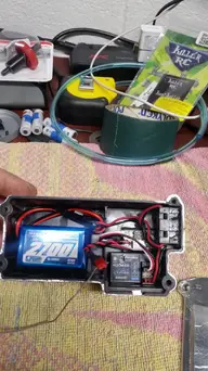

Here is my rx box. Little lipo rx battery, futaba rx, killer rc super bee kill switch

This is a pic of me mocking everything up to be sure everything fits right. Any bigger of a steering servo would not fit
