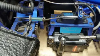

You can also try using either a piece of fuel hose we use for these gas engines or I've seen guys use the hose used for nitro it's more flexible. Anyways, cut a piece of hose about the same length as the spring and put in its place.20180415_203517.webp
