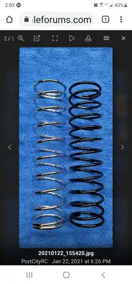

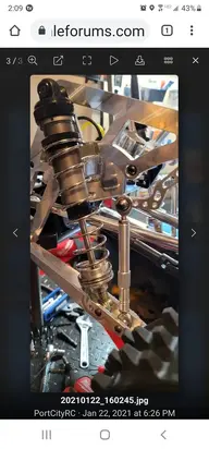

For the kv5, the spring is different on the rear of our tt kit trucks
That's the oe tt spring...I'll look through my thread I have the comparison photos, my photos on my phone got wiped on me?
These are from my thread, definitely an upgraded tension to our tt springs, I have the weight specs of the tires and everything on my thread page. I'm still going to look into custom shocks and springs as I still could use more. I've messaged shock therapy, but their strokes. And a custom spring set for built for the weight of these rigs shouldn't be to hard to obtain.
