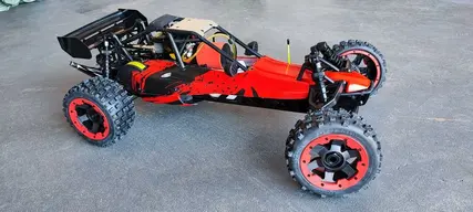

Please take a look at the video in the link below. Any one has this problem before? The servo is behaving very funny. This is a truck by 30°N, everything is stock. You can see that the transmitter is just beside the truck. I have changed everything and the problem still exists. Servo, transmitter, receiver, kill switch, ignition coil and battery have been changed.
The next thing to change will be the engine itself. I think the engine with the kill switch is causing the problem. If the kill switch is disconnected, the servo is fine. But I cannot run without a kill switch. I have replaced 3 brand new kill switches to this truck and the same happened. Put those kill switches on a Baja, it work fine. The one on the Baja originally, I put it to the truck and the same problem happened.

The issue happened only when any kill switch is connected while the engine is running. But those kill switch used on other engines in another cars are working well. I am using this kill switch as shown in the attachment below.
