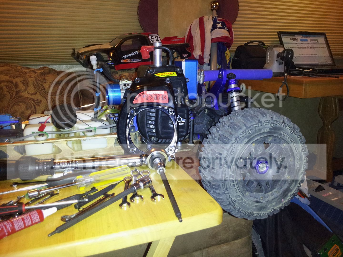

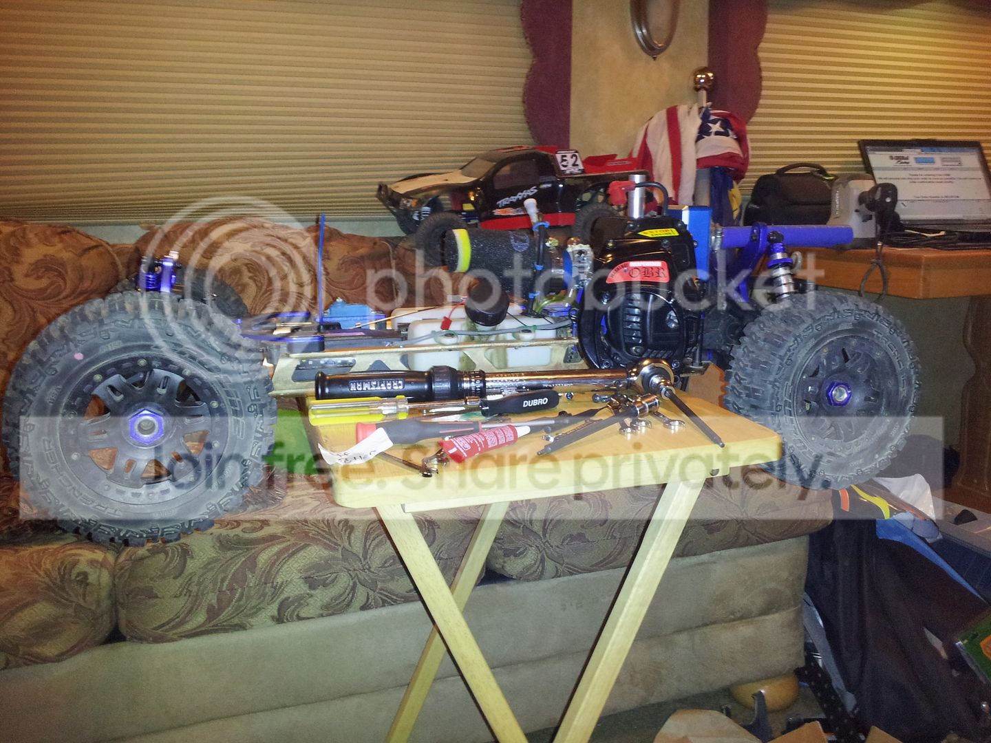

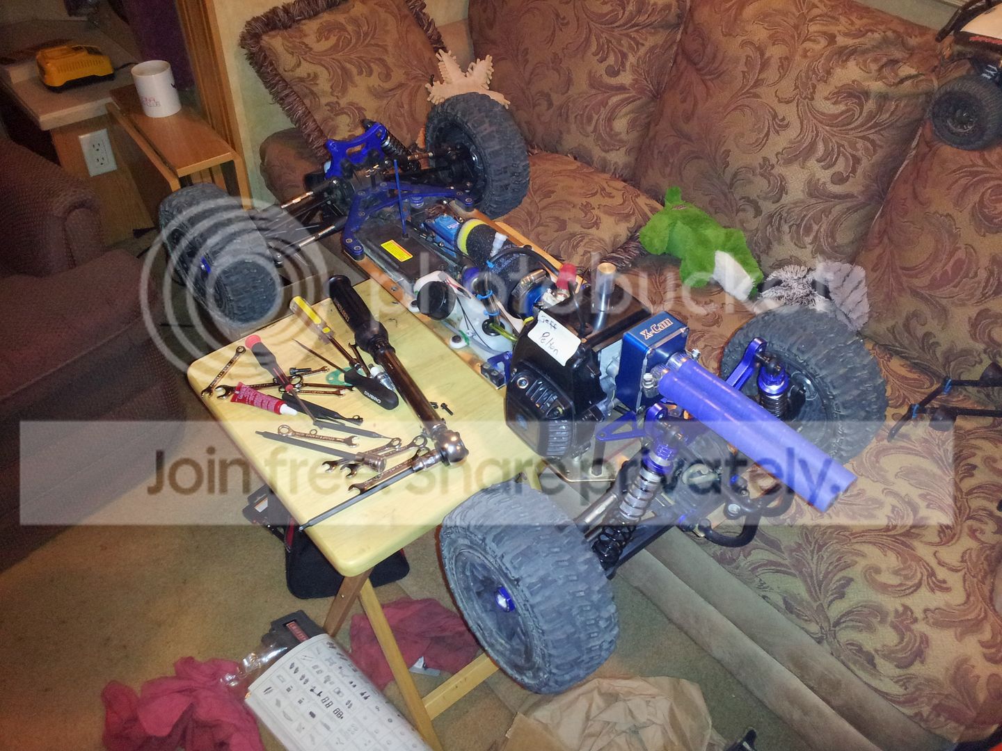

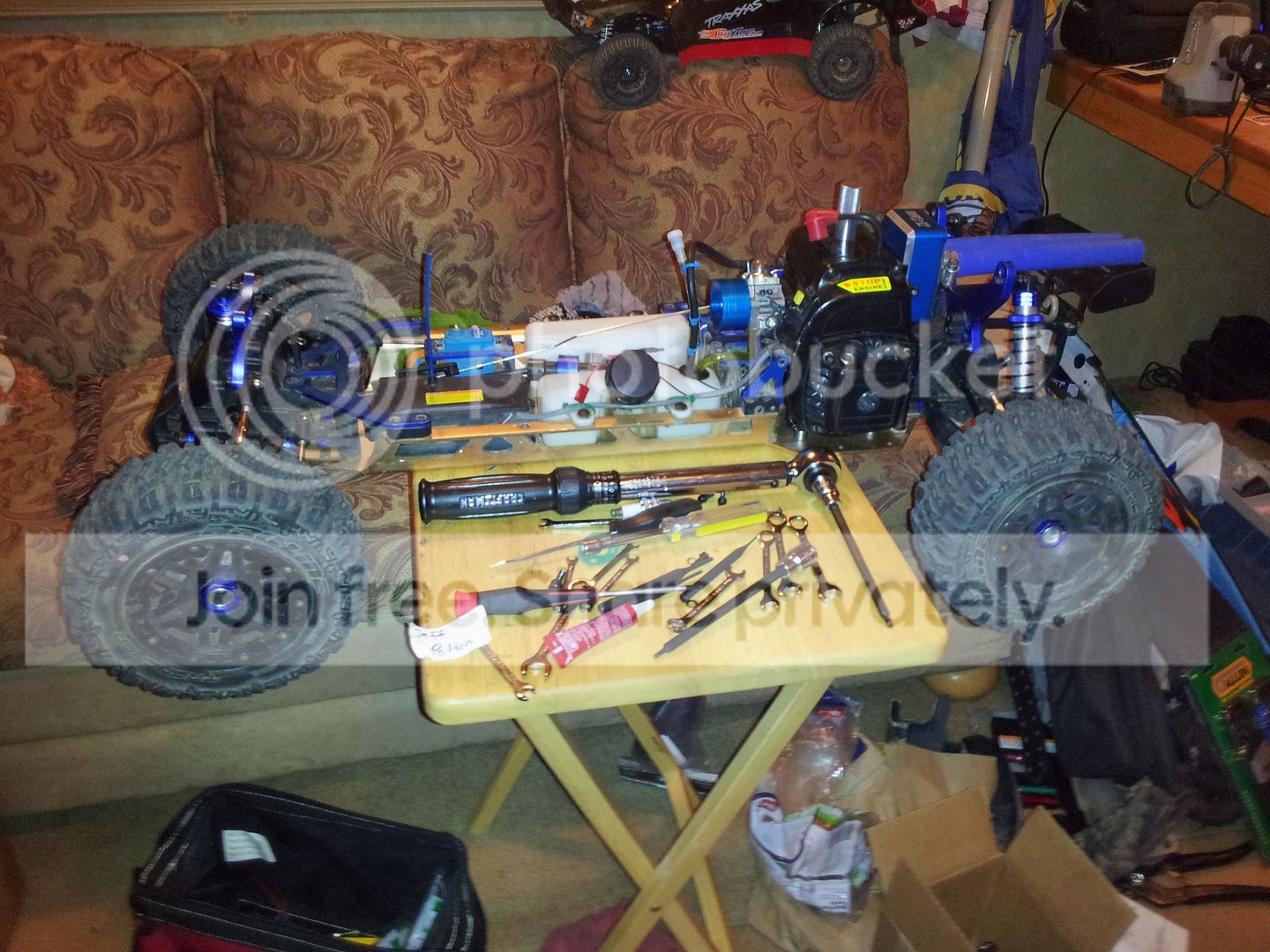

Got most of the Dune Runner put back together today. Couldn't use the Zenoah case cover, the spacing of the bottom screw mounts is different on the bottom of the fan case, so I had to use the the HY case cover. Right now I'm waiting for new front shocks from DDM, I tried 3 or 4 times to buy them from RedCat Racing using Pay Pal, and kept getting Server Error.
A couple of pictures.
Can't use a Zenoah fan case on a Dune Runner, the screw spacing is different.

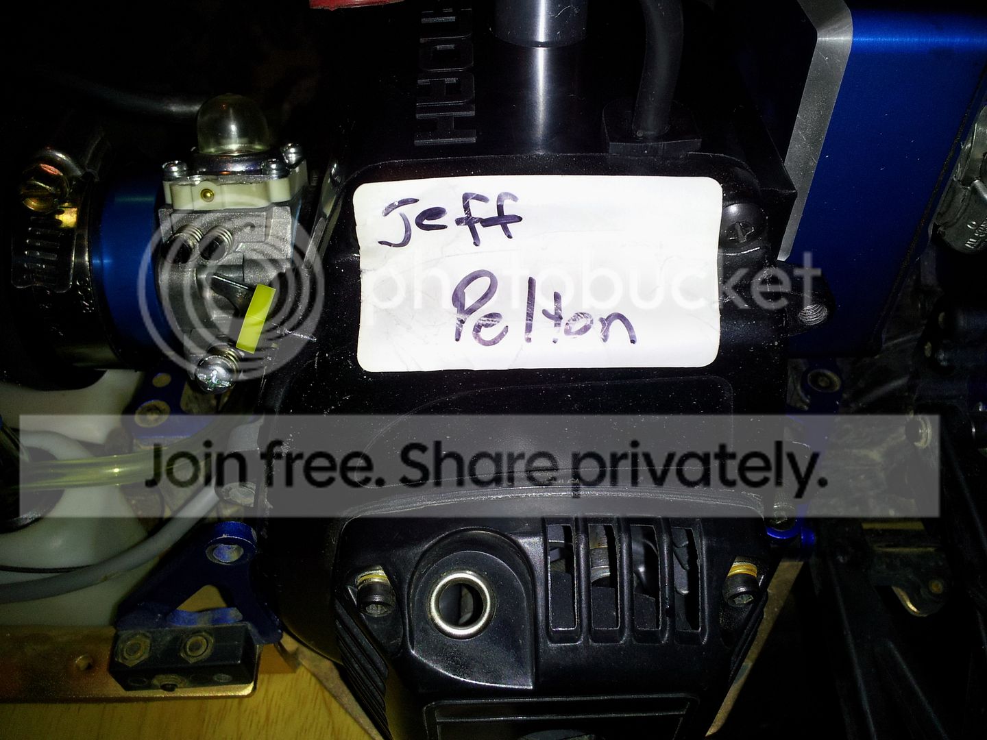

Didn't take a picture of the etched OBR info, but here is the sticker over the exhaust. Recognize the writing?
Yep, it's a OBR engine.
