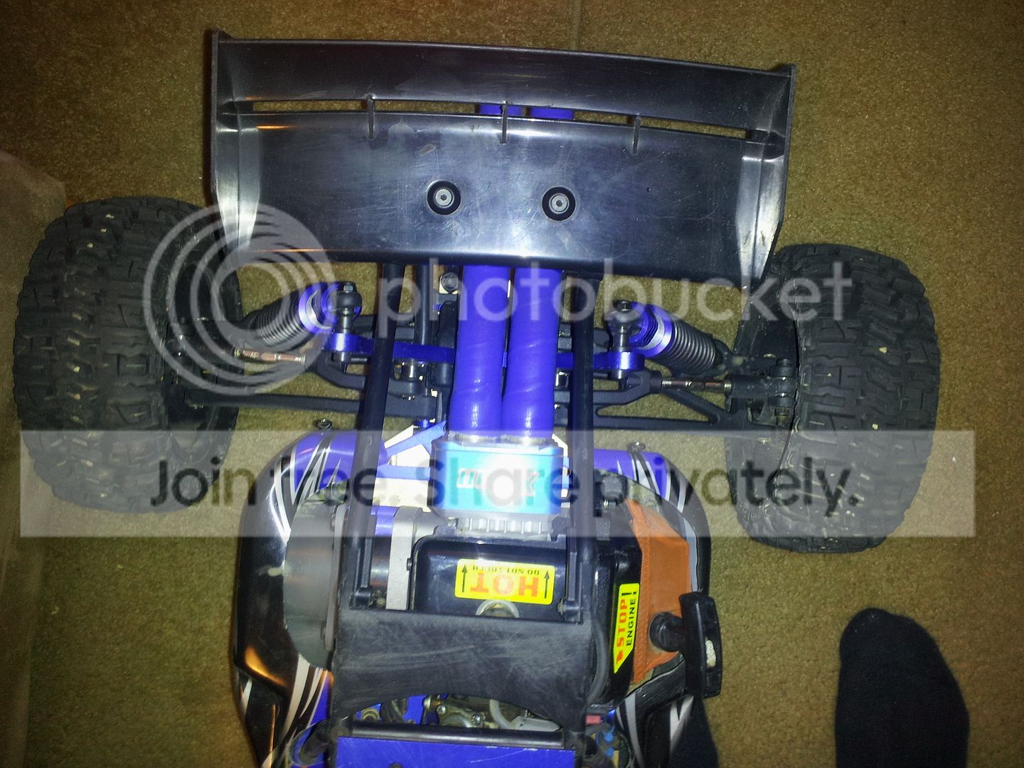

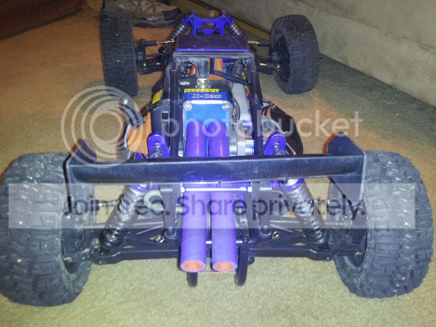

Just got the silicon tube I ordered from Silicontube.com to run the exhaust past the wing from the X-Can. The tubing wall is lots thicker then I thought it would be, and 4 ply. Plus, it's soft. I WAS thinking I could use the tubing to tune the exhaust a bit, but... With the wall thickness, and the softness, I doubt it. Too thick, too soft. I think the best I can expect is keeping the back pressure down. I'll find out this weekend.
HOWEVER, it will keep the exhaust off the wing! And look good doing it. The blue cover of the tubing fits in well on the DR and the blue X-Can!, and the exhust noise should be lower :)
Got back from dirt bashing at work after the hardware store closed (I maintain/fix mountain top radio sites in the desert) and put on the silicon tube pipes. Tomorrow I get hose clamps, but, the silicon pipes are shrinking around the X-Can stub stingers.
Didn't need oil, just some old fashioned knowledge to get the tubes on the stubs. Angle them on the stub, twist and PUSH! Keep pushing and twisting and DONE. It took around two minutes per tube.

Spent today running around doing chores so I didn't have a chance to run the Dune Runner. One stop was the local hardware store where I picked up some hose clamps. And discovered with the thickness of the silicon tubes there isn't enough space (None) between the tubes to put on hose clamps at the X-Can stingers. Hope there isn't any leaks, but you deal with what you have. Even with some leakage it should be an improvement.

I cut the silicon pipes at 8", I lucked out on a "sweet spot". It's on the pipe as soon as I hit the trigger from a start. I think there is just enough back pressure. Plus getting rid of the stock air cleaner and adding a tall venturi.
